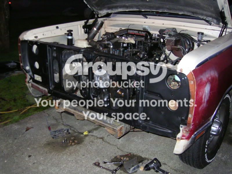

So up to the weekend....I pulled everything off the front.
Then installed my new rad support.
And if you recall I modified my rad support just a little to fit my Non-IC, down flow rad. I only needed to add a small "bushing" on the bottom bolts below the rad, I used some 5/8" heater hose. Now I don't have to worry about it hitting those bolts and rubbing through the lower tank.
I then had to make up some brackets to hold the rad in place. I used some box braces from a mid 90's chevy pick-up. I liked theses because the ends were threaded and ran a good sized bolt.
I then had to cut, bend and modify the pieces to get them where I wanted. A little welding and grinding had them ready to go.
The lower mounts I had to drill a new hole in the rad support, then make the brackets. But I had to run an additional washer on the bracket so that the lower mounting mount, that usually slips down over an already threaded bolt, would not bend and twist out of the way....I figured this out the hard way.
