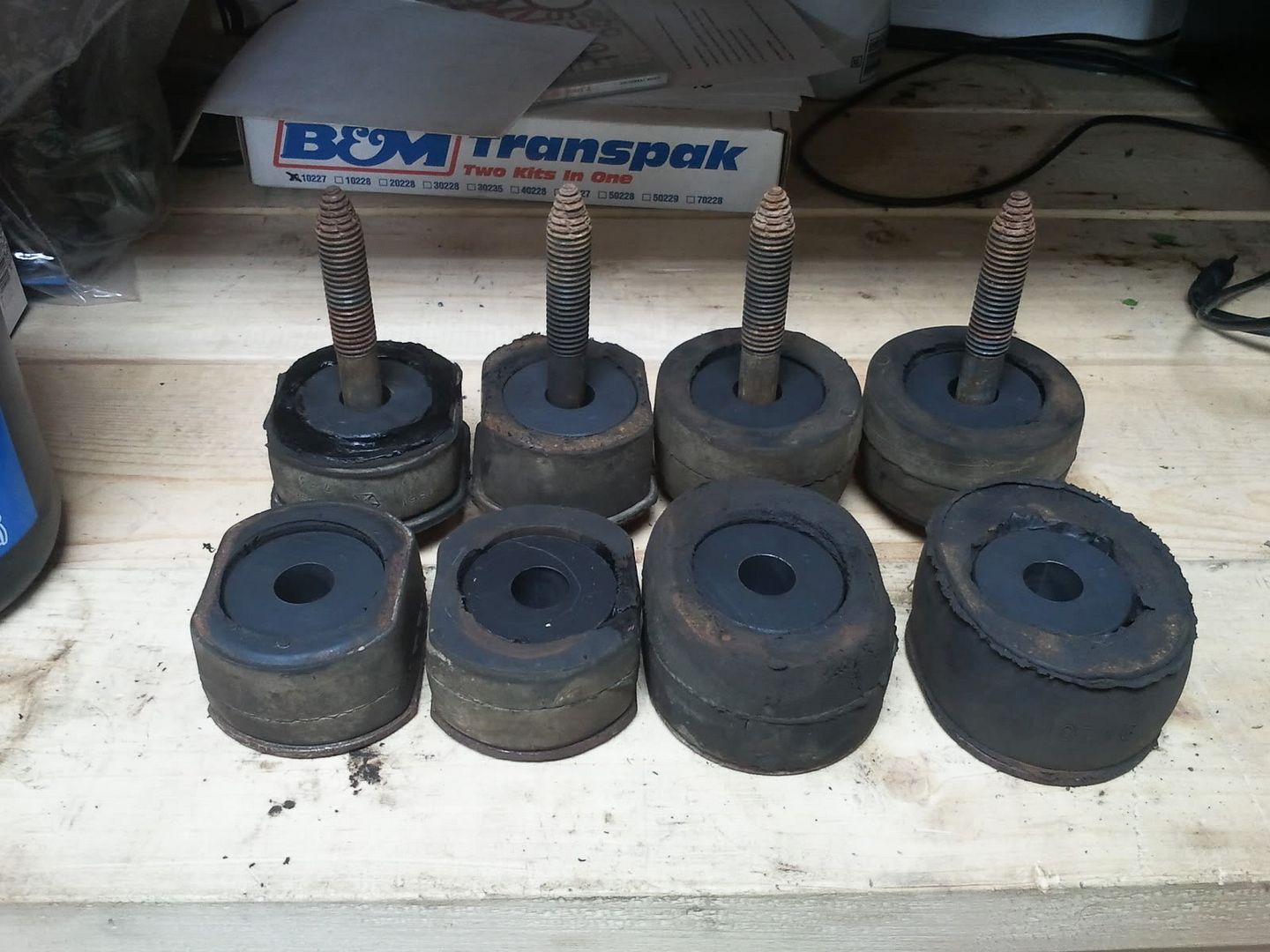

I liked the hell out of 'em. I would've suggested that but I had no idea you had access to bushing stock like that which is why I'd said pipe. Nice work! :dance:
Thank you. :)

Got my bushings finished yesterday.
