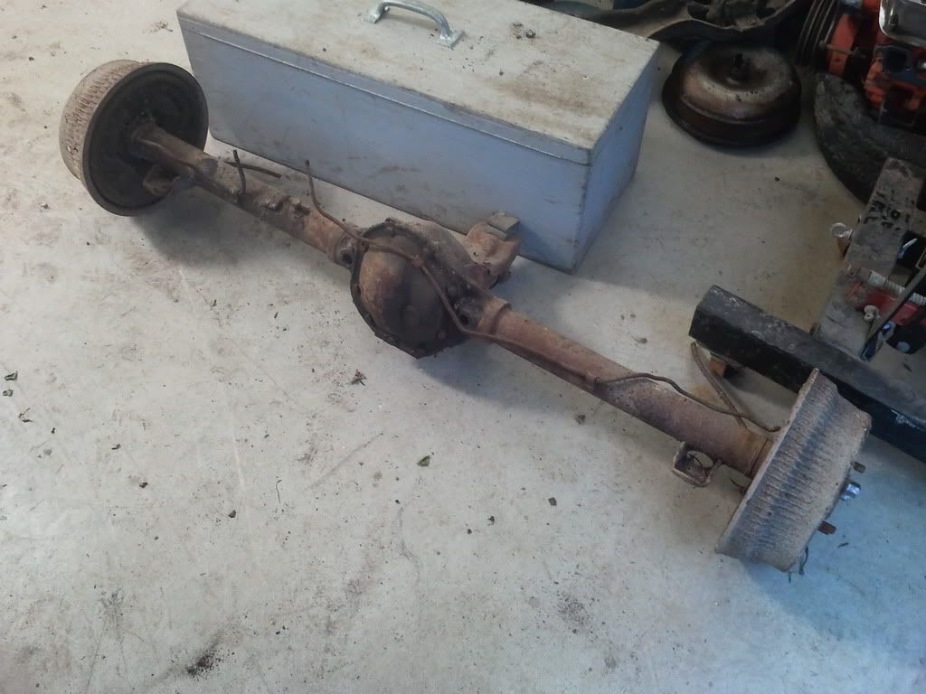

The diff I took out of my 1980 Diplomat /6 station wagon was suppose to have 2.45's in it and after I pulled the cover it has 2.94's. :doh:
So I have to swap those out with the 2.45's I have on the shelf.
Got the rear disassembled.

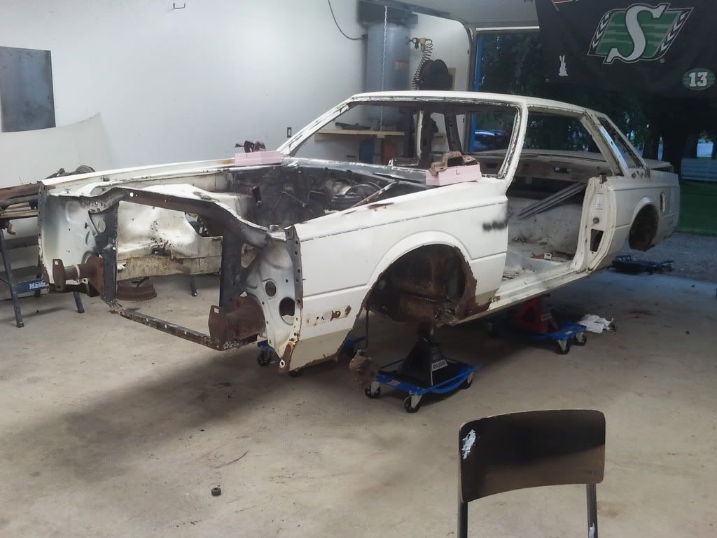

As for welding the cage or ANYYTHING on the body while building that car, do yourself a big favor and take it off of those roller stands. Take the time to make 100% sure the car body is perfictly leval! Do what ever it takes to make sure the car stays 100% perfictly leval while you are building the cage and or welding factory seams. If it means installing ancors in your floor and chaining the car down while you are doing it, then do it. The stiffer and squarer you can build that car the better the suspension will work.
On a side note, If you have ancors in your floor you can "pull" the car back after a wreck.
Take your time when building it too. Take notes. Lots of them. Mark your frame where the stands are when you build it. Mare the stands positions on the floor when your building it. Mark the stands so they can go back in the same place on the floor if you need to "Pull" somthing. Plumbob all of your axle centers. Weld a small tab on your frame rails so you have a "Known place to measure from if you ever need to get the axle back where it once was.
Keep a not book and record everything you do in the shop and at the track. Record everything. Qualifing lap times, are temp, humidity, tire air pressure before and after each race, Record tire temps on the inside, center, and outside of the tread after each race. (All you need for that is an infra red gun). If you can measure tire temps across the tread of each tire you can get a good read of your alignment settings. If you change anything, change only one thing at a time and record the result (good or bad) in your note book. If you change more than one thing at I time you don't know what one made what result.
Read the book befor you start changing spring rates! Watch for some racing scales on line and buy them! Knowing corner weights is huge chassie setup. If you can get your hads on four grane scales they will work too. Just make sure whatever scales you use, to make sure you mark the floor and the scales and always use the same scales in the same spot. And make sure they are leavel to eachother!
I hear yah about keeping the car level. I plan on taking those roller plates off before installing the cage.
I'm also planning on rewelding alot of the major frame seams.
If the car gets hit hard enough I can straighten it at the shop. No need to ruin my new garage floor with anchors.

hell if you want to be able to keep it on rollers.....make yourself a jig thats strong and level and WELD the frame to it ....i spent alot of time calculating level building my lloyd.
a good car starts with a level square and true chassis regardless of what its doing....hell i would even go thru that much trouble welding in frame rail connectors..in fact i have gotten out the lazer level to help check everything was spot on when doing it
Frame rail connectors would not be allowed be cause they are not stock and would be a blatant modification.
My sub frame connectors will be a roll cage.

I realize that you're on dirt, but sliding is slowing. You seriously have what may be the worst front-end design ever for dirt-track circle racing (hell, any racing that involves turns), so you really need to know how to keep that thing pulling as much as possible. The better you can hook the rear, the faster it's going to be... and that goes back to Stretch's comments about making sure the car is totally square when you weld the cage in so the suspension can do its thing. I have an NOS '81 chassis manual with every measurement to make sure the car is square (it didn't change from '80).
Stretch knows from whence he speaks; heed him and you'll be unbeatable. Stretch, remember when Mike Gardner was invincible in Street Stock? Someone claimed his engine, and the next week he kicked their asses with their own old motor. That car was built like a brick brick. :D
