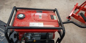

I bought this back in 2014 to work in a house before the power was on. I let gas dry up in it many years ago, and knew it needed repair, then last winter my BIL came and insisted on borrowing it. I knew it wouldn't start but thought the exercise yanking the rope might keep him warm so I let him use it.
When he brought it back, of course it hadn't started and it leaked a bunch of gas on the garage floor before I finally noticed it. I had to fix it anyway, so no big loss but it was curious how trying to start it caused a fuel leak in a basically new generator.
The first video I watched only talked about fuel drying up and blocking the primary jet and used acid to clean it. I used a piece of a wire bread tie. Once that was clear the motor hit on the first pull, but wouldn't run without the choke.
Next I found out about the pilot jet, which causes exactly that. You can access it from outside the carb so you don't have to pull it to work on that. That was too clogged up so the wire didn't work. I also tried welding wire to no avail, and eventually used the smallest drill bit I have to clear it. Then it would start and run but it would rev, kick the governor, rev, etc.
I think my bit cleaning the pilot changed the size and is causing that so I put a new pilot jet in yesterday. I don't know if that fixed it because because I'm not finished and I don't want to put gas in it just yet. The revving could also be that the throttle screw had to come out to access the pilot jet and it isn't exactly back where it came from (I counted turns from all the way in).
While I was fixing the primary jet, I noticed the shutoff valve didn't work. I also found that the float valve was stuck open. Those two things caused the gas leak - the float didn't stop flow into the carb, and the shutoff valve didn't stop flow out of the tank. The fuel just drained right through.
FWIW, if you're just going to replace junk with junk and not try to upgrade the thing, I found a carb/shutoff package deal for less than a carburetor alone. I had done several Amazon searches before finding it though - the best deal never shows up the first time.

Whie I was reading what you'd done, I wondered if you'd looked into just replacing carb. I have a very similar generic-ator (4000W peak) and last I looked, the carburetor was about $14. I need one for mine because the fuel tanks rust very badly in those units. I think I bought the fuel tank for under $40 shipped before I realized the smiting it had done on the carb.
Still need the carb, of course... thanks for the reminder!
Ethanol based gasoline is the scourge of all small engines. (weedeaters, chainsaws, lawnmowers, mopeds, etc.) As the good Doc pointed out, replacing parts piece-meal costs more than a replacement carb. But these carbs are mostly low quality Chineseum. I've found that the best course is a thorough cleaning & rebuild of the OEM carb is the best route. And, AVOID ethanol.
I bought a spare carb, new shut off, and a fuel filter for $15. The pilot jet was $10, but I wanted to get the carb I've got working because my thinking is/was, I've got ot going now, but if it happens again, I know how to clean the carb I've got. If it's too cold/dark/etc to mess with that or if I can't get it working I can just slap the new carb on it and get it going.
I should invest in a whole house natural gas generator anyway but I think would be a nightmare getting the cable from outside inside and figure the installation cost on that would be ridiculous and would prefer to avoid having my backyard trenched for it.. This little HF job should do the trick to avoid losing a fridge and freezer full of food though.
As is the original in this case. These ain't Honda generators, 68, they're low-rent ripoffs thereof. There's no real argument for keeping the original. While I've not used one myself, I've directed a number of would-be carburetor customers to eBay and/or Amazon, and all have worked out well. One customer has told me numerous times that his $18 eBay Kohler carburetor (one where I'd have stuck with an OE myself) still works like a champ. He bought it about 4 years ago. I told him at the time, "Ethanol-free premium only if you want it to last." It's lasted.
I was just looking at the generator lockout kits yesterday at Home Depot, completely by coincidence. Simple enough to do yourself, other than trenching for the cable. You'd probably have to have an inspector sign off on your work, but it's not terribly difficult to do.
