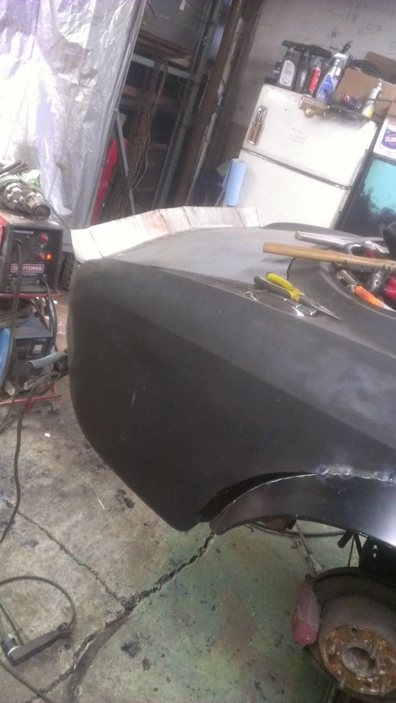

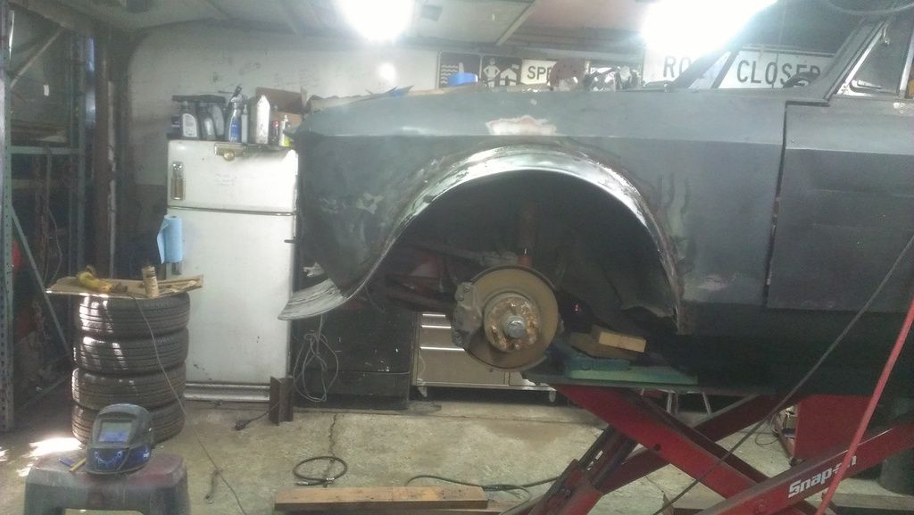

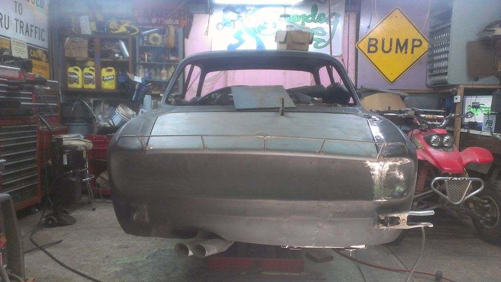

this....ooooodles and oodles of body work..but..allmost all of the metal work is behind me...finish up the rear duck tail and fender flares and it will be primer and filler time...ive been quite enjoying the work too
side note....
if anyone has any ideas for tail lights SPEAK UP!!!!!...looking for something that wont look like trailer lights..im currently leaning tward 1970-75 jag xj6 turned sideways....the space is slimmer than it looks(right around 4-5 inches max)

Jag lights might be a very good fit.

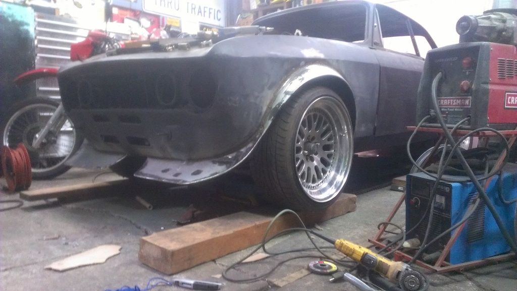

Where is the guard on that yellow grinder?????
Right off the bat I thought, "1969 Barracuda taillamps flipped upside down" but I expect they're too large for the spot. The shape's nearly perfect, though. Nothing else comes to mind immediately, though, other than something custom. To my eye, you've got to find something that works with that shape. Cutting and grinding plastic sucks, but maybe if you start with something large (3rd-generation GM F-body springs to mind) you could figure out a shape cut the lenses to size. You won't have a perfect, ready-made housing but the housing doesn't have to be perfect, just a little smaller than the lens itself--nor does the shape have to be exact.
belive me 67 and 69 both came to mind..but are massivly too large..ive wandered all of the "old" wreckers hunting for ideas...and have turned to ebay....the "early" 50s ford pickups have a lense that would have looked beautifull in there turned on their side...but..1 inch too large...belive me cutting them down the centerline to shrink them still sticks in my head....another option i looked into was 70s honda bike lights as they have a similare curve with point going on
at this point ive randomly hunted 50'-70's and very little looks like it may work..save for the early 70s jag with its "teardrop" ish look...im not sold its "right" thus im hoping someone may have a solid idea

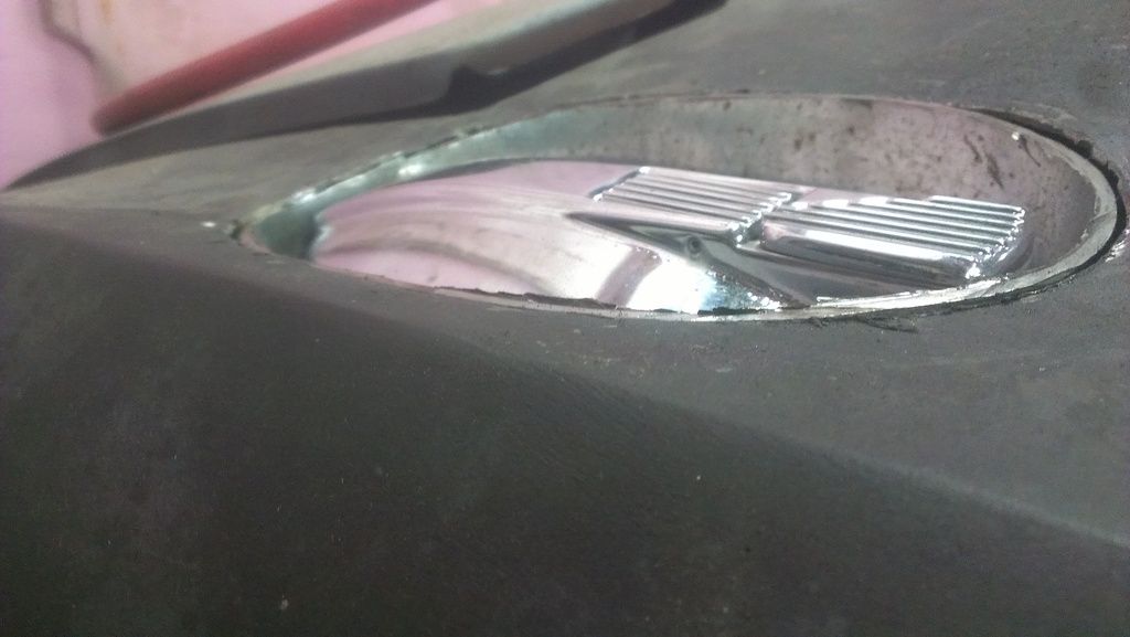

as for the major "race" body work..ive been drawing from other generations of alfa and following my instincts and 70/80s imsa styling..and i feel like i nailed it the flares are heavily modified 280z jdm pieces everything else is hand formed...the jag gas cap was a bitch to get right...i block bucked it and couldnt get it to sit as low as i wanted due to opening angle and body smackage
its the first thing that ALWAYS comes off cause its ALWAYS in my way..yes..i am aware of the dangers

I thought of early celica tail lights....
[h=1]Toyota Celica 76 77 RA29 RA25 RA28 TA27 liftback banana tail lights [/h]
Or 240Z tail lights...
Yeah hard to tell in the pics how big those taillights might be...but sure look more then 4". That is going to be a tough one. I think of pinto, maverick tail lights...but don't think they would suit the car.
Just throwin' this idea out there. No, I don't have spares, but the '72-'74 lights are generally pretty inexpensive since they're rarely damaged and the lenses are even-more rarely cracked, crazed, or faded. Top to bottom across the outside of the beveled edge is almost exactly 4.75", while length across the same surface is around 9.5". The actual lens and reflector size is much smaller and just the recessed area is a scosche over 4" across. A clever fella like yourself could pretty easily use just the backup lenses rather than all four, and make a divider to separate the white part of the lens from the red part as far as illumination from the inside goes. You could even use amber bulbs in the white area as a separate turn-signal filament, assuming you've got somewhere else to go for backup lamps ('69-'70 Charger units spring to mind there, down in the valance). You'd just have to work out how to illuminate the separate sections, as these housings are single-lamp units and the factory bulbs install from the bottom rather than the back.
The only real drawback is you're working with pot metal. Very heavy, strong pot metal but pot metal nonetheless. I've never tried to work with the stuff so soldering, bonding, etc. is out of my area of expertise.
This idea, of course, also brought to mind 1970 Barracuda taillamps, which could be inverted since the shape of your tail panel is almost an upside-down E-body unit. Those install behind the tail panel, too, so you'd merely have to cut holes and figure out the mounting. Well, that and spring some coin for the lamps themselves. They're a lot more expensive than the ones for my car, which often sell for well under $100/set--I've seen 'em as low as $50/pr. "Buy it Now" on eßay. You could also use the tragic '72-'74 Barracuda tails, but you said you didn't want something that looks like trailer lights. :D
