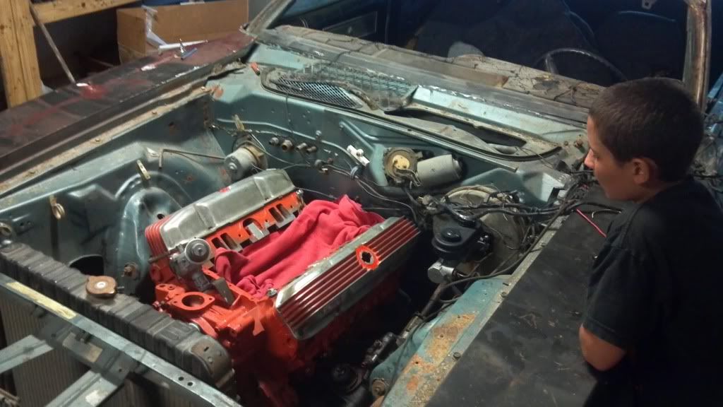

Set the motor in the car, finally... still have a bunch to do, but I did clear up some space in the garage.
Looking good, 71. Man, I'd forgotten how ugly AC firewalls are in those cars... but it's easily to get over with an icy blast from the dash vents! :dance:
Yeah if the plan wasn't to drive it as much as possible I'd consider getting rid of it. But with an A/C season that could start in the beginning of April and end somewhere in October with days it could be used into December it's not going anywhere.
