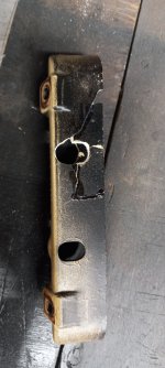

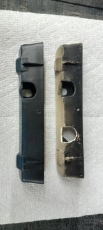

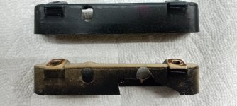

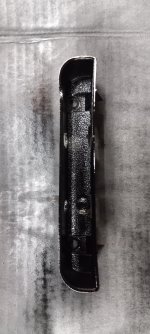

Jass, I tried the operation on the door pulls to try & save you from digging around, it might actually work if my screw up doesn't fal apart?
Started by drilling a bunch of small holes & then carving out the rest, first hole pretty good! 20240206_160327.jpg
On the second I had a drill bit that was just a tad smaller than the hole, figured wow one shot & no hour of carving, well that didn't go well the bit caught almost instantly & took out a big chunk! 20240206_160341.jpgSo I carved out the rest & it fit pretty good20240206_160400.jpg
Now if that little dip in the bottom is necessary, I may have to just drill another hole
Shot some paint & the one chip up top is just inside the are rest so it might not be seen.
Turns out these are both left side pieces, so the R marked one is the one I need if you already have them located?

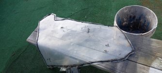

How important are the sheets of plastic they stuck on the inside of the door & quarter window frames.
I have a couple of pieces mark took off his jeep that I could do the quarter windows with.
Did nothing on the other car.
If I do need to buy some for the doors what mill plastic should I buy?
It's a good idea to replace the plastic. It's a fantastic vapor barrier. And we all know what moisture does to door panels, and it helps slightly as a sound & dust barrier. I've been using the same plastic is normally used as a vapor barrier for home constructions. A little heavier than OEM but hurts nothing.
If you know any builders or remodelers they always have leftovers. If you don't find anything say the word, I can send you a big bunch.

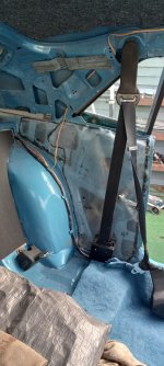

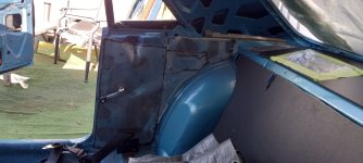

Got the splash shields on, I read a couple of things that said passenger side from engine bay side, but looking at it, it made no sense, so I went with both from the wheel well side! 20240209_124022.jpg20240209_123044.jpgNow you can have a little laugh, you have to picture this old fool out there peeling the black goop off the plastic sheets, it took a while & my hands are a mess, but saved me from postponing the job.
Used a slightly smaller bead, but it seems to be holding. 20240209_144830.jpgPass side was3 pieces, drivers side I managed to cut it right& did it in 2. 20240209_134359.jpg20240209_145155.jpg

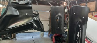

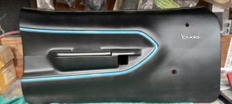

Last but not least I finished off the clear on the interior panels, think I made it to close enough! 20240209_162054.jpg

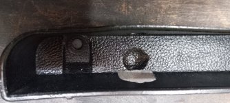

Pulled the tape off the panels, did a few small touchups & so far just moving then around & wiping off the dust hasn't marred them, hope this stuff is tougher! 20240211_133511.jpgSo I went ahead & put in the arm rests & emblems with my reversed pull maybe I'll get lucky the broken parts don't show like a sore thumb, now will it fit the lock lever ??????? 20240211_135905.jpg
