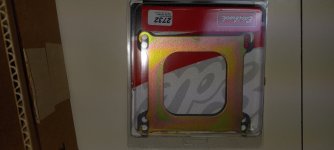

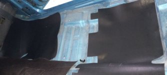

carb plate arrived, studs BO'd to sept. 11 ? 20230823_132048.jpgSo I laid out the sound deadener, I kinda wish it was just the jute like padding I got with the other carpet.
many holes to cut, the tunnel dotted lines don't seem to line up with much & there none around the hole for the shifter rod through the floor? 20230824_132606.jpg20230824_132616.jpg20230824_132630.jpg

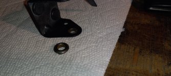

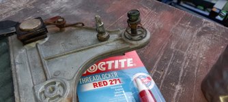

then I attempted to adjust the quarter window a bit, that turned into a 2 hour project, just as I had it close I pushed back on it to adjust the last bolt & the bottom bolt on the glass bracket popped out!
Managed to get it back in only to find the threads stripped.
Removed the glass & into the shop, found the next size bolt, just a tad longer. Drilled & tapped the bracket for it & figured I'd use lock tight for the "stop" 20230824_142045.jpgGot the whole thing in & then discovered it was flopping around a bit, bolt back in the shop, could not find anything to sleeve it with so I cut 1/4 inch off some black tape & used that! 20230824_145944.jpgPut it in AGAIN & she still has a little play but the glass is close now, the bottom of my door needs to come out a little so till I get that sorted out I won't mess with the glass.

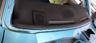

Now windshield is going in Monday, this looks awful close to where a ton of black goop is going, should I tape off the front of my nice new pad?

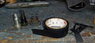

Digging around to set up to get some parts on, brake pedal should be good to go, I got the new plastic bushings for that20230827_151234.jpgBut not for the gas pedal, mine are shredded on one side20230827_152913.jpgGood side up on the one off it & down on the other, 20230827_152924.jpgbad side up on both.
If I set it up with both going in from the right there's no play in the shaft, but the one on the right will just back out, would that wonderful goop glue hold in in, or maybe sleeve the shaft?
I guess the first question should be does anyone have a source for these? 20230827_153447.jpg

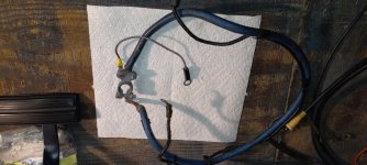

Dug out the speedo cable, want to get that in before the column goes in, same box had the rigged up pos cable & the ground strap, will clean that up a little & then see if I can rig the extra radio ground to it where it bolts into the fire wall! 20230827_160110.jpg20230827_160053.jpg
Holy crap, just spent over an hour trying to get that pad down, crowbar in the corners to get the side adjustments to bottom out & center punches to try & get the 4 by the window as low as they will go, lost the metal that held the U nut in by the vin tag, it's just spinning, will try & crawl under in the am & see if I can reach it?
It's friggen close everywhere & it has a bow up right in the middle of the front, that might still hit, I'm hoping the 3/8 inch goop is wide enough to clear?
The factory part number was 2899351 (two required), but it's long gone and never superseded. The bushings were used on everything except A-bodies after 1970 and stayed the same through the end of the "first RWD" era, last being used on the 1989 M-bodies (Fifth Ave, Gran Fury, Diplomat). I was surprised to see they were ever serviced, since I've never had an accelerator pedal I felt needed attention. Anyhow, they're gone now. You could try taking measurements with a caliper and slogging through the bushing selection on McMaster-Carr's website.

Here's that bow in the middle? 20230828_095043.jpgSo I put the washers 1/4" right there. Looks like it will clear fine20230828_094939.jpgCorners ok too! 20230828_094917.jpg
Everything looks good to me. Those washers are a good approximation of where the glass will actually sit.
