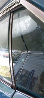

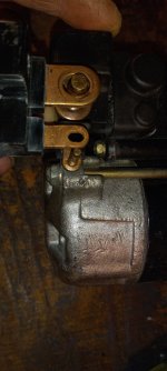

In the meantime I managed to get the drivers door glass in by myself. lines up nice with the roof seal, but I need some adjusting where it meets the quarter window, probably have to mess with both? 20230820_125653.jpgNow that starter wiring adaptor I showed earlier came off this starter I bought when I first got the 74, will I need it with the new proper cables?20230820_110313.jpg& finally when I was putting in the up stops, this piece popped off in my hand, could not figure out how & where to put it back, is it important? 20230820_131640.jpg

The starter cable adapter may work on your car; the spacing on it is different than the spacing on the actual starter. Check it against the cable when you get it. On my 440, the adapter had to be removed because it hit the block. That's not an issue with the small-block engines.
