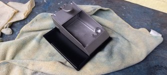

Lock set arrived, they look correct, still waiting on my door handle, but at least I can freeze while I try & get the trunk lid/latch assembly on. 20221209_114220.jpg
Dang I could use these things, too bad it looks like my pull handles are 2 of one side, can't seem to locate the other ?

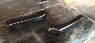

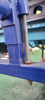

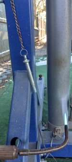

Does hydraulic fluid freeze? couldn't get my jacks to come down, ended up heating them with a torch20221214_133130.jpg

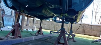

Got the front to work but the back wouldn't budge, the main upright that slides down looked cocked a bit, raised the front a ton till that looked straight, even with that when I lowered both ends the back was still in the air buy about an inch, had to lower the top section a lot to finally get it on the stands! 20221214_135618.jpg
She's finally down, padded my stands to hope to save the paint on the rails. 20221214_135600.jpg

I wouldn't expect hydraulic fluid to freeze unless it had some water in it.

I have no idea why it wouldn't come down when I opened the ports,

Has your rotisserie seen much water? The main shaft seals on them never seem to keep all the water out, I change the fluid on Sno-Ball's plow system every year and it amazes me how much water gets in from sitting...and we don't get a ton of rain here.
I'm guessing it could also be from the cold, the fluid is thick and heavy and the internal seals are probably sub par and allowing fluid to push by and not building pressure?
It went up just fine, when the rear finally decided to let go I had the valve pretty far open & it dropped a good 6" in one fell swoop!

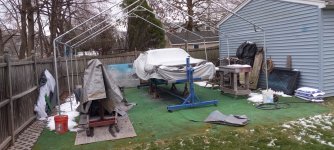

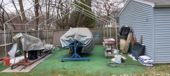

winterizing day! the tarp came down without a fight, no wind helped a lot.
got the soft cover on first to hopefully protect my paint.................20221215_135017.jpg
this top tarp is actually half of the tarp I lost to the snow last year, tied it off pretty tight, see how long it takes for the weight of the snow to start pulling it down into the open engine bay & shred the tarp?
double tarped the engine, tranny & rear end...................... 20221215_140907.jpg
got the soft cover on first to hopefully protect my paint.................View attachment 24720
double tarped the engine, tranny & rear end...................... View attachment 24721
Do the homeowner rules prevent you from putting a roof over that? I've got a neighbor with a pretty big one that's not much more than that same metal work with a roof on it. It probably doubles up on the number of "wall studs" and rafters, but maybe not. It's stood for as long as I can remember. Pretty sure it's set in the ground though :D
