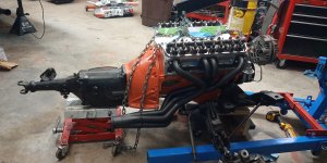

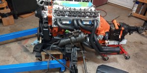

Both headers are on now. Had to grind a little bit off the bellhousing on the passenger side. It's kind of right against the steering gear with no shims in the mount. Unsure if shims would help there or not.
Photos coming. It's close to the starter but it's clear and that's good enough.
I can put my finger between the header bottom terminal on the starter, and have about 0.10 between the header and the solenoid at the closest point
It sits smack up against the steering gear though. It looks like it was meant to be a little bit forward so it fits through a curve cast into the body of the gear. Don't know what I'm going to do with that; maybe I've got the mounts on wrong? Shims made it worse.
Had to grind a little off the bellhousing.
I used a wire clamp and the bellhousing support bolt hole to strap the battery cable against the block.
I've got it sitting pretty level and supported on the cart. Note the driver's side photo above isn't on the hook.
Other than the tube touching the steering box, I think it's ready to roll under and lift. I'm going to experiment with the load balancer to get it set where it will lift the engine straight up as much as possible.

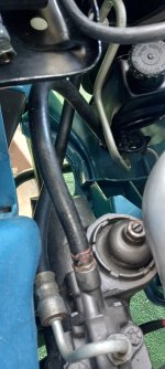

Now the power steering hose doesn't fit. I thought I ordered the right thing, now I'm wondering if I'll be able to use this pump/bracket or not because there is no earthly way the hose I've got is going to connect to the pump.
It had a Federal pump on the 400, this is a newer model Saginaw. There's not enough room between it and the k-frame to get the hose in place.
The nut at the bottom is the pressure outlet. This is the hose I bought, top is the pump end. There's no way that's going in that tiny gap.
The hose for the car the pump bracket came from has a male connector on both ends. Overlooking that for now, it doesn't look like it would fit in that small gap either. No surprise due to the change from biscuit to spool.

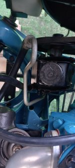

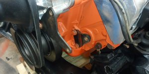

Since I actually own a '71 LA-engined Mopar with power steering, I thought to look through my own pictures. While I don't have a clear shot of it, the one picture I do have shows the early-style Sag pump reservoir, but no hose behind the pump, i.e. nothing visible. The factory put a battery tray in my way:
The area highlighted in yellow NE of the accursed tray is the garage floor. There's nothing behind that pump, but I'm almost certain the hoses are in place (in fact, I think one's visible under the battery cables). If you're wondering why I have so much clearance behind the pump, it's because my car has AC, which moves the pump even further forward (check out the offset in the rear bracket compared to yours).
But, and this is important, there's no qualifier for AC in the PS hoses. There's only one pressure hose listed for LA-equipped E-bucket with Sag steering, and it looks like what you've got. I suspect that the hose, in your case anyhow, needs to be installed first and that the hard-line end immediately goes beneath the pump headed toward the core support, hooking back around to point the rubber part toward the steering box, which also has a direction-reversing metal end.

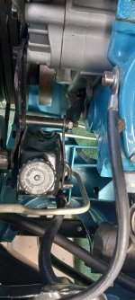

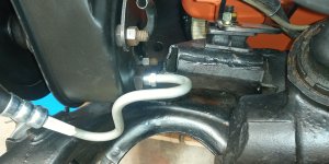

Hey I gotta run (Easter) but just spent an hour of quality time with the PS pump and here's what I found.
There's no way the hose will fit.
That is with it pulled all the way up and there seems to be nowhere to go in the other direction. I did scan and saw Jass noted it should go toward the core support, and he is right. It just won't fit this K-frame.

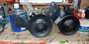

The pump from the 400 is on the left. The brackets are very similar other than how they attach to the pump.
It has a side exit.
I thought it might fit the brackets, but no. The spacer is way short.
To use the Federal pump I need a bracket that doesn't have that dogleg in it. Checked one vendor, found each and every part to hang the pump including bolts for $90. Ouch. And I just looked again and it's every bracket but the ones that mount to the block. I don't need those.
