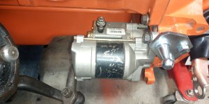

The headers don't go all the way to the head. That would be a no problem situation with a full sized starter.
Is there a different clocking / setup on these things or am I going to end up buying one of those hyper expensive Robb Mc starters (or knocking a huge dent in that tube)?
Fiddled around with it some more and it fit better but it's still flat against the starter. This time I had the front two bolts in and snugged with the gasket, and the rear-most bolt in and snugged but the other one on the back tube didn't want to start. Probably needs to come up just that little bit more.
I'm having a hard time imagining that not being a problem even with a divot knocked in it there.

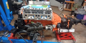

Also, with the smaller cart I'm starting to experience that tipping back I was concerned about from the start. Look at the mount and the ears on the k-frame.
The larger cart held it up by the drag link but was in the way of headers.
20240324_134326.jpgNow the headers fit but the mounts are in a bind from the k-frame wanting to roll backward off the cart.
I tried adding some more 2x4s to get it to move my way but the weight is all behind the centerline of it
Right now the transmission jack is holding it closer to level.
I still had a hassle getting it close to in place because of the steering. Hard to guide and lower all at the same time. I'm gonna just go ahead and make some spacers to bring it up some.
To get it to sit correctly, you're going to have to work out something for the back of the transmission, period. I'd suggest something where the transmission mount bolts to the tailshaft. Maybe just a single caster on a riser would do it (something using both transmission bolts). You need it to sit level with the rear support and the K-member supports all doing equal duty. The drag link is too far forward and not something I'd want to rest 700lb on in a manner for which it wasn't designed.

I was hoping there would just be a different starter that wouldn't hit the headers, but I'm thinking they all have the same design and I'm going to end up beating the heck out of those brand new pipes trying to get enough of a dent in the right place to clear that connection.
My options seem to be knock a dent, buy a clockable starter RobbMcPerformance - Mopar Starter, or buy a full-size starter and see if that will work.

Why isn't the cart supporting the rear of the K-member?
I need to rework it so it extends more to the outside and rests under the LCA, yet stops before it gets into the header area - so somewhere under the pitman arm area maybe?
I'm limited by the width because of the V-shape of the picker legs - if it's too wide I cant get the picker far enough over it to reach the rad support and pick the car up. Coming in through the side opens up a can of worms related to how high I have to pick it up to get it under and the very process of shoving it in there sideways and wanting to turn not roll. So I'm choosing to being the engine straight in from the front.

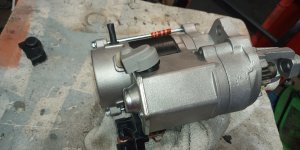

5.7 starter hits the block. It might work on a different small block but it sure won't work on mine. So that gets returned.
The block curves out there at the solenoid so with the starter hanging on the lower stud it bangs smack into the block at the top.
The mini starter I bought gave me a little more clearance that the first one did, but not a lot.

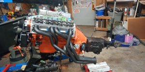

I took the header back off for now so I could easily get the motor back on the k-frame, then tried to change the cart to support that better. Mission accomplished - still not perfect but a lot better.

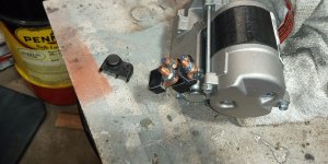

One thing I've got to figure out - the starter has a plug-in on it for the solenoid wire, not a stud and nut. So I've gotta find or make a pigtail for that. I'm hoping I can find something in the HELP aisle.
Dorman makes every pigtail known to man except the one I need for the starter solenoid. Taking it back to with me to the parts store so if they don't have that I will just return the stupid mini-starter too.
Stuck this here too if you didn't head out already?
Googled it, only one that had anything but the regular connector was sorensen 13A46-6TA tat had 2 little ones at the starter on spade for a lug & one that looked like a straight connector coming out the other direction .
It did give me a mopar part #, 56020393 when I googled that they all had the regular round connector???

With my luck it will fit just like the first one and I'll end up denting the headers to make it work, but at least they're raw steel so there's no coating to be careful about.
