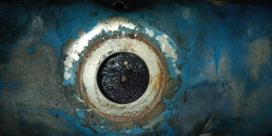

I'm confused what I'm supposed to run in those holes too - breathers? In both of them? The grommet in both is closed off. A breather will fit in the hole but it won't push all the way in with them like that.
I figure them to be leak-prone, they're kind of flimsy.
Breather in passenger's side, PCV on the driver's. Mr. Gasket sells baffled grommets, but you may be able to modify those into something similar.

I just wish there was a way to clean the factory parts.
There is, but B-body-babe would butcher Bob and bury his body bits before he beheld the benefits... and that would happen before you even got to the part involving the dishwasher.
I cut the baffles out of the valve covers on the Valiant because they wouldn't clear the rocker arms. They weren't really any dirtier behind the baffles than they were elsewhere. But, if they're really sludged up I'd suggest a soak in gasoline, plenty of air-out time, then having your machine shop bake and wash them. If the shop doesn't have an oven, throw on your rain slickers and break out the power washer.
Flip-side argument: If you can't get it out of there, neither can the engine. Don't sweat it too much.
