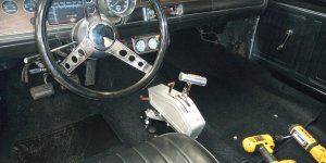

Got it. Debating if it's worth taking it all back out to paint one piece. The 16 gauge and standing on bolts makes it a little bit bendy if you get carried away with it, but not bad.
Need to trim the carpet and install the rear hold down trim, kick panel, and sill plate, then seats and on to the next mess.
I was originally going to say, "Only if it continually draws your eye and irks you," because to me it's not a giant eyesore... it just sortal looks like part of the shifter. Then I realized it's probably steel and have hence changed my answer to "If it can rust, it should probaby be painted." Obviously that won't happen overnight, but it'll start to discolor and develop tiny spots fairly quickly.
Cool, collected cucumber that you are, I wouldn't expect that to be an issue... unless you're the simian previous owner of my shifter, in which case I'd suggest you increase the bolt diameter and use grade 8. 😁
I guess another answer is how long is going to be in there anyway. The previous setup had a cruder unpainted piece of sheet metal over the shifter hole and it was rusty as heck but it took who knows how long to get to that point. OTOH, one drop of sweat and it's insta-rust. It might come down to if I take it apart I'm going to figure out a way to cut the holes/slots more precisely and then make a new one out of a heavier gauge.
See prior comment about heavier gauge steel, and also note that if you look at it close, the back more-than-half of the shifter isn't supported on the bolts too. That could have been tied in better.
might i make a recomendation?...get some thin ABS sheet and make a cover for it, or even a loose carpet cover for it...of course like you said...how longs it going to be there
even painted, unless the hardware is painted too its gunna stand out
Yeah that's true

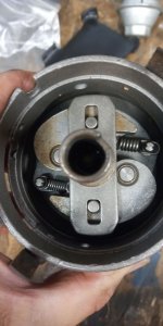

I need to get a better shot of the tag so I can start googling the part number to find tuning tips. There was an argument I mean a thread at moparts recently about these things. They apparently made them for decades so maybe someone has written up part numbers etc to help me out here.
Worst case I buy one of the newish Mopar distrubutors that parts and info are available for. I've got one made by Mallory in the A12 that has adjustable advance etc but I'd rather leave that right where it is.
Those internals are straight-up Chrylser production bits. Even the notch for the pickup wiring looks like it's for the stock grommet. I'm surprised the advance springs are that heavy--they literally look like 318 parts. Mr. Gasket's 925B advance spring kit will drop right in. In this case, an OE electronic distributor would be a huge improvement for the vacuum advance alone. It doesn't look like you need the tach drive, so there's really no reason to use that distributor. It's no better than the stock part, except possibly the lower collar being metal rather than plastic (if it is).
The first thing that comes to mind with "slow revving" is an intake leak... so I'll preach my standard sermon: Use the tin turkey pan only, with no gasket facings. Use Permatex High-Tack spray on manifold-to-head surfaces of the gasket and black silicone on the ends. Everyone uses those gasket facings (except Chrysler) and everyone (but Chrysler) has issues. No, it doesn't matter whether the manifold is aluminum or iron. Throw the facings in the trash can.
