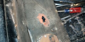

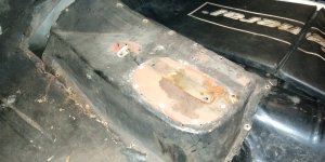

I removed the shifter and 4-speed hump to come up with an idea of how to install the shifter without making a mess of the carpet and allow the carpet to be used in the future if/when I switch things to a small block 4-speed. The hump was held in with sheet metal screws and stickum, so I pulled the shifter and hump off in one piece to give easy access to the shifter bolts.
The best idea I've been able to come up with for the carpet so far is to put in a neat round hole, and use a grommet when the cable is needed and a plug when it's not. Cut a neat(ish) X in the carpet for the cable to exit through and slap some gaffer tape under it to close it off when the cable isn't needed. The cable has to exit the front of the shifter so there's no way to run the cable completely under the carpet.
I'm also thinking of fabbing up a mounting bracket so I can limit the shifter bolts to being just in the cover over the 4-speed shifter opening. Right now it bolts to that and to the hump itself.

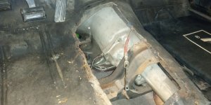

I replaced the jamb switches yesterday. Surprising that you can't use general purpose one wire switches, but you can't unless you want to hack the harness. But I have a working dome light now, and remembered to pick up an antenna gasket too so that's all installed now.
Still working on the shifter and hump, in my mind. I looked for pre-built shifter mounts and there didn't seem to be anything for this lower end shifter (B&M Pro Ratchet). All I need is to come up with is something that bolts to a plate blocking the 4-speed shifter hole, raises the shifter up high enough to where I can put the 4-speed carpet trim in place (without the boot), and bolts to the frame of the shifter. I'm thinking some 1" spacers and square tubing will do the trick.
I also see that per the Holley (B&M) site that the shifter should have a NSS and BUL switch in it already. That would be good since the backup light switch in the trans isn't working.
I looked closer after not finding a switch or switches on the shifter, and see that the switches come in the box and the user has to install them. I guess whoever took it out of the box didn't do that. I guess it's possible that it's such an old model that they weren't an option then.

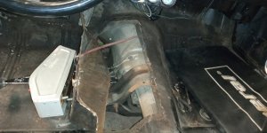

I would strongly suggest putting the seat(s) back in place before you do this. I'm not sure if you've got a bench or buckets, but A-body shifters were mounted rather high and used long handles. B&M essentially designed that shifter for GM F-bodies so it might be a bit of a reach on a Mopar A-body. Yeah, it's an automatic but constantly bending to reach the shifter gets old quickly (as does a ratchet shifter, but I digress). Since you're raising the shifter anyhow, do your test fitting with the seat in place so you can determine a height that works comfortably from your normal driving position. Yes, the cable will be more visible, but you can always paint/vinyl dye the jacket black so it's not as obvious.
depending on the cable design you might be able to just sheath it with shrink wrap as well, i second the at the very least drivers seat in place, relax with one hand on the wheel 1 hand on the shifter
put it where you "think" is comfortable and then put both hands on the wheel close your eyes and reach for the shifter and when you reach down inevitably dont find it where it should be DO NOT move your arm or hand, open your eyes and look to see how much you need to move it and move it...repeat a few times, the trick here is that your memory is more important than your VISION, i learned this real fast building the lloyd due to the fact i was mounting well..everything in new places

The NSS is wired correctly, so I'll go back and revisit it, because I sure as hell don't want to take the switch out of the transmission with how tight the exhaust is there.
The way I understand it to work is the outside pins carry 12v (approx) or not when the trans is in reverse or not, and the center pin is grounded when the trans is in park or neutral. The outside pins go to the odd shaped connector on the firewall, the center pin goes to the starter relay. One wire on the odd shaped connector is always hot, the other wire goes to the light sockets When the car is in reverse, 12v from the hot wire passes through the switch and out on the wire back to the lights. That's from memory but I'm pretty sure that's the way it goes.

Also, that hole in the hump from a punch and hammer is now a round hole that a plug or grommet will fit.

what id recomend on the switch is to crawl under and put a meter on it and test it in N, R, P, as the reverse lights is the simplest system in the car, and changing out said switch is EASY

I think I did go ahead and ring out the switch to confirm it's screwed up, but not sure.
I'm pretty sure I can't get a socket on the switch because the exhaust is right there. I thought I took photos but can find them. I might be able to get to it easier now that I've got the hump out of the car.

I threw together a shifter mount that screws down where the 4-speed boot goes and raises the shifter up using a combo of 3/8 nuts and 3/4" square tube. I keep forgetting to bring the camera in though. With the setup I can put the 4speed carpet in and when the engine/trans swap happens, little to no work will be needed to the interior.
I didn't bother to put the seat in because the shifter is sitting right where the 4-speed shifter would be, and it's raised up about an inch but even if it turns out to be too low it's a simple matter to take it apart and add height.
