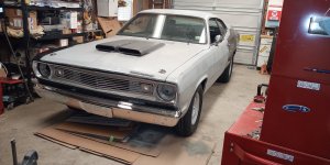

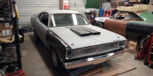

With lights. Too bad it's not painted, but It's Good Enough. Still need to glue lenses into the front sidemarkers. I bought new lenses but they were pricey so I'm trying to hold off on installing those until after it's been painted.
I'm getting to the point of not knowing what to work on next. I guess it's time to get it titled, insured, and licensed.
This weekend I hope to throw a coat of rustoleum on the inside floor board and figure out if I can work the shifter cable in without hacking a hole in the new carpet I've got waiting.
It's startin' to look like a car, Bob.
You've got to get some black behind that new grille of yours, though. ;)
Yeah, eventually but that's a can-o-worms I'm not willing to open. That turns into oh yeah the body needs painted, and man that engine compartment's ugly, and the next thing you know I've got a rolling body, a pile of parts, no body/paint skills and nowhere to do it if I did..
I've got one car torn apart for 10 years now because it needed some sheetmetal work and paint. I don't need a second one. I know myself. Paint and body work is someone else's job, that I'll have to pay for.
