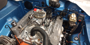

Got the hose installed, didn't fill the rad just in case I have to take something back apart.
Tip on the cut to fit lower hose - just go ahead and cut the top short bend off. It's the part at the far right
Don't get carried away and cut it too low, just cut it off square a little below that bend so it's only got one bend at the left to go toward the radiator.
Waiting on the throttle cable parts so I started sorting out the wiring; everything is way too long because it moved from the front of the engine to the back. I need to cut out a quick block-off plate for the two A/C holes in the firewall and make sure all the holes are closed off one way or the other. I'm out of satin black paint, so didn't do it yet.

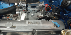

I can't get full throttle. Back to this:
1722270408094-png.28110
Note where the ball is to the right of the forward spacing spring, below the large hole.
I think I need to move it to where the forward facing spring is. Maybe? I'll have to cut another cable if so, no big deal but I'm still doing a little figuring before going through that. I've also got an A/T adapter if I have to put that back on the linkage.
Ok I think that got it.
I don't like it. It's hard to tell in the photo but the cable and the springs are all running in different angles. Nothing is aligned with anything else. It might get replaced for aesthetics if nothing else.
I don't like it.
That makes two of us. 😄
I'm not sure where you had the cable connected in the first photo, but in the second it's clearly in the wrong spot. The large hole at the top of the throttle lever is the intended connection point, at least on GM cars. On Chryslers, the 20-7 adapter is needed to connect and align the factory parts with the aftermarket carb (also true of Elder Brocks).
The cable misalignment is because you're using universal one-size-fits-none parts with 2V cable bracket, and attempting to correct that misalignment with a cruise bracket. Left the way it is the cable will abrade on the edge of the ferrule. It'll either groove the ferrule, wear through the cable, or both.
The hole where those rear-travelling springs are connected to the throttle bracket is the anchor point for the throttle-pressure (kickdown) linkage return spring, not the throttle return spring (which always went forward). It's not supposed to align with anything but the end of the factory throttle stud. The forward-running spring is misaligned because its factory connection point is also the throttle stud. Neither spring was connected to the throttle lever.

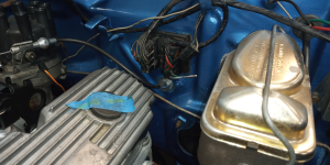

This I learned last night - I probably should have invested in a new engine wiring harness instead of patching this one up. Might do that along with the throttle cable after the motor is proven.
Also I was half smart on my wiring adaptations - I stuck a terminal block under the dash for the tach, gauges, stereo. All good and well. Where I dropped the ball was failing to write down which wire goes where. I've got an orphan wire under the hood that I think goes to the coil for the tach or maybe not. It's the only place it could go but I didn't tag the loose end either. Laying in the floor trying to figure out which wire goes where puts me in that focal distance where my glasses don't help and looking without them is even worse.
This is stuff I did pre-startup simply because I didn't want to have issues at the outset. Engine harnesses live a tough life so I just went new out of the gate. In my two stints as a car electronics installer, the same is true for dash harnesses, except they're usually trashed by someone previously attempting what I was there to do... the ol' twist-n-tape, Scotch-Loks, whatever butchery comes to mind.
That being said, barring new wiring (dash harnesses in particular ain't cheap) it's well worth taking the time after the wiring is all buttoned to verify everything electrical works as it should before you attempt to start it. Does coil (+) show ~8V with the key in run? Does it jump up to battery voltage twisting the key to start? If you don't want the engine to turn, you can take the trigger wire off the starter relay to test those or you can test resistance instead of voltage.
While I replaced Agnes' engine/forward lamp harness right off the hop just due to age, I got lucky on the dash harness. The only cut wire was for the cigarette lighter. While I had the engine harness unplugged, I took the time to thoroughly clean all the terminals for the dash harness at the bulkhead disconnect.
And, since your car is an A-body, I'll recommend you thoroughly clean the ground for the forward lamp harness, and the grounds at the turn signal housings, which are kind of corrosion-prone on the '69 Valiant turn signals.
