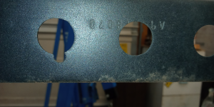

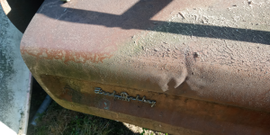

Yes the three (3!) decklids I've got are all factory original. The one I took up came off the car so it's got the center of the underside hacked out. I've got another one that has a tough dent running up and down through a curve that runs the opposite direction, and of course I've got one that has the lock cylinder slide-hammered out of it.

I think I'd try to fix the lock cylinder opening, given the three options, not that it's in a particularly easy spot to access. Then again, I guess that depends where the dent on the other runs.

For the $500 slide hammer mistake it seems to me like they make a gadget that you fit into the hole, hold one side, tighten the other, and it reforms the lock hole. Or maybe I imagined it and never invented it. I haven't dug that one out to look yet, but it feels like the locating slot is still there so such a gadget may actually work.
