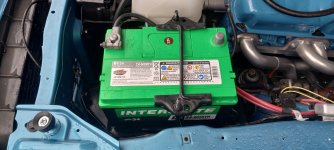

Not much done, rainy day, did get the battery hold down done, the thicker rod did fit on the other side, so at least they are the same. Still need to connect to the inner fender. 20240328_150517.jpg
Good thing I left the pos. off, I left the key in over-night!

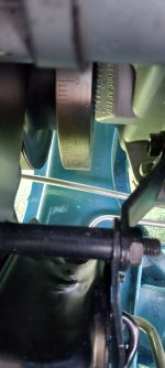

Put on the starter button & at least that worked, so I pulled the front plug & brought it up to compression, the balance was a tad off zero & got lucky a quick bump & it's real close does it have to be exact? 20240331_134549.jpg

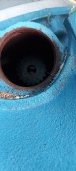

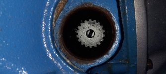

So I checked the oil pump shaft, that is pointing about between the back two plugs on the drivers side.
I assume that will point the distributor the same way.
Do I dare pull it up & try to spin it.
In one of the pics you can see the silver bellhousing to get an idea of where it is.20240331_134807.jpg20240331_134911.jpg

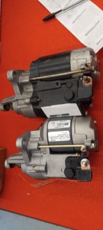

Smaller starter didn't really help with the clearence, there's a hair of daylight on the new skinnier black rubber20240331_133819.jpgPretty tight up top too20240331_133709.jpg
