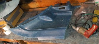

concentrated on the worst panel, tried everything, 40 grit dry was too aggressive & put some scratches in the plastic,80 grit got a lot off, then I went to wire wheels, started with a fairly soft 3" & that got most off, no damage to plastic, then I put on a little harder 2" for the stubborn spots. it's getting there.
that's the 2" wheel on the drill...........................20230123_153913.jpg

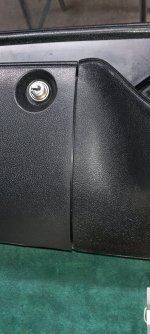

So I put my new lock mech. in & the casing is hitting the catch so it won't pop open(spring loaded)

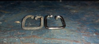

noticed the bend so I dug out the one I stripped off my console..............20230126_144124.jpg
Went to tighten mine in & the plate in the back stripped (BOTH SCREWS) 20230126_145815.jpgI did strip that plate off mine, & also kept the hinge, I think I have a good black bottom section, will go out tomorrow & mess with it a little more before I vent back at year one for a sub standard part! 20230126_150114.jpg

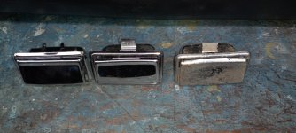

Last was the ash tray, I thought I had a really nice on, turns out it's slightly different, don't even remember where it came from, probably ebay 15 years ago, the middle one fits but has some rust marks down in the tray!20230126_145835.jpg

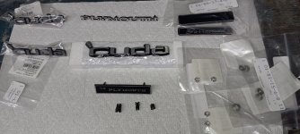

Door handle is in..............& emblems look ok, did waste some money on those 3 black speed nuts (bought a bag of each size) I thought I was getting ones like on the right for some of the other parts of the car? at least they were fairly cheap.
door panel ones do have the studs, so make using different panels harder. Tail panel is stick on? 20230126_142456.jpg

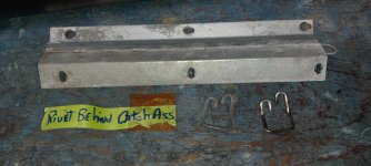

I cleaned up my old latch catch & glued the old base plate behind the plastic.20230128_134543.jpg

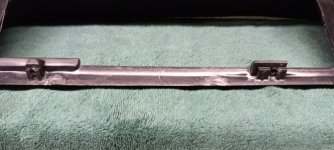

these are the receptacles for the screws on the skinny side, one hole is way off & I had to file them back a bit for the edge to fit flush. 20230128_133911.jpg

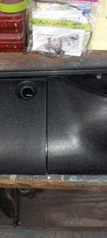

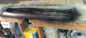

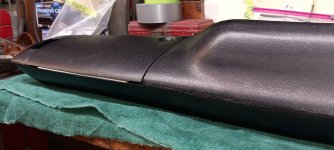

And a coat of clear, helped the look a little, it's a bit shinier than the top, do I dare shoot a coat of clear on that??20230128_143427.jpg

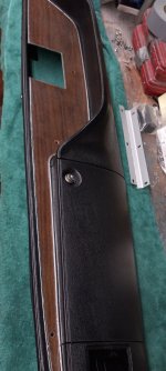

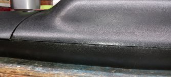

The battle with the console is over (well for now don't know about fit in the car?)

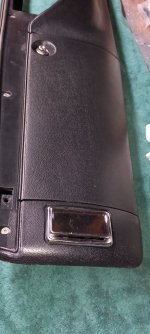

After bending the catch a bunch of times & changing the lock a few times I finally got it to latch down good & release, still doesn't really pop up but I can open it, new keyed lock is in.
After seeing the big difference with the painted bottom I decided to try the new one & see how close I can get it.
door is pretty close, I ended up putting my old hinge on it had a slightly stronger spring. 20230129_144207.jpg

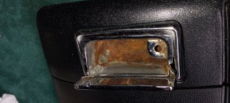

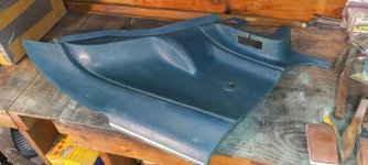

back seem is a little ragged 20230129_144303.jpgSo then it was down to the ash tray, put in the bezel & the tray with the rusty gut 20230129_145430.jpg20230129_145444.jpgfor some reason I took another look at the good one, turns out the bezel is different but the trays are the same, well what do you know something went good! 20230129_145623.jpgSo I cleaned up the wood grain plate, think I'll go all new on this the chrome is pretty beat up? 20230129_144935.jpg

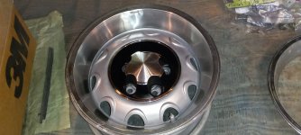

So the new wheel paint arrived so I shot the last 2 rims, it's a bit darker & more metallic, hope there's enough left to at least shoot over the other 2. 20230129_144646.jpgAs usual I find another problem, when I put them flat on the bench they are different widths, so now I go around & measure all the others, all 6 1/2 , with one 7" how that happened I have no Idea, guess the 2 I bought were one of each, the last 6 1/2 was the worst rusty one still sitting out in the weather, can I use the 7" as the spare?
trying to have a rally spare in stead of the plain black rim? 20230129_144658.jpg

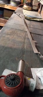

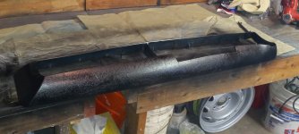

I pulled the front bumper filler out & it was way out of shape in the middle so I set up the heat gun , did manage to get it close, then I realized there's major parts of both ends missing!20230130_143417.jpg
I'm hoping I don't need it, I'm leaving off the major hunk of metal that they mounted behind the bumper for that 5mph crash rule. not sure how far that will pull the bumper in ?

the good news is 3 of the rims are done, waiting on more of the new paint to finish off the 4th, the 5th will probably wait till spring when I can set up my blasting tent again & get the last one cleaned up
Removing the impact bar will only move the bumper in about ¼" or so but also remove a bunch of weight, which is good. Even though I had a complete F/R set of good bumper fillers for my Challenger, I bought earlier bumper brackets. The worst thing about the '73-'74 E-bodies' exterior is the bumper guards. The second-worst thing is the slack-jawed look of the protruding bumpers. I bought '70-'72-style mounts, '70 non-padded rear bumper guards (you have to have something; those are the cleanest) and 1970-'71 bumpers without the jack slots.
It's all OE-replacement stuff, but it's so much cleaner-looking than extra holes, bolts, and giant rubber cushions.
