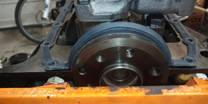

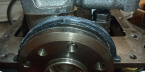

I wasn't kidding when I said the one piece fit the rear cap better than the Fel-Pro.
Milodon:
Fel-Pro:
It will be fine.
I guess you'll know eventually. I don't claim to know; depending on who's complaining there's either a difference in how it fits the rear of the oil pan (not the rear cap) or there's something different up near the timing cover. I don't have two pans I can easily compare, since my only Magnum pan is bolted to an engine on a cradle.
I didn't see much difference in the way the two parts look as far as the end pieces go. I'll try to remember to fill the pan before installing the engine but that might not show a leak if there is one.
