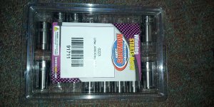

I went ahead and ordered the cam and lifters - went with the Howard's lifters because it kind of feels like buying insurance against flat lobes. :D If it turns out I have to pay Summit's price for them, I'll likely reconsider.
The only time I've ever seen lifter kill a cam was when Muscle Motors built an engine on which the #6 intake lifter bore was out of round and the lifter couldn't spin. Of course, it took four camshafts before he realized it couldn't be something we were doing wrong (the rest of us knew after cam #2). Muscle Motors went good for it after determining the issue, re-blocking the engine, supplying yet another new cam and lifters @ no charge, and paying the shipping both ways. It's a damned shame they're now a marijuana grow operation rather than engine builders. They stood behind their stuff.

Lifters received today.
