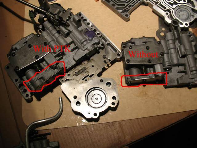

The valve body is identical between all 727s and 904s within the same years, as long as we stay within the boundaries of lockup/non-lockup transmissions... so yeah, you could use the valve body out of a '78 Slant Six 904 (non-lockup) if one's available.
I recall the 1972-'75 valve bodies being the ones to get but I'm not sure anymore. It probably goes later than that assuming the donor is non-lockup. The years listed would be safe bets. Valve bodies older than 1969 may not have the part-throttle kickdown assembly, which you absolutely want. Without it, you must completely floor the accelerator to pass. If memory serves, all auto Slant Sixes got PTKD starting in '66 but it took awhile to hit the V8 transmissions. The 727 out of my '67 GTX did not have it, and the guy who bought it was not a fan of its operation. The accelerator had to be figuratively in the water pump for that transmission to downshift whilst passing. Beyond that, I seem to remember reading there were some minor upgrades in '72 that made it a better performance unit.
"Now Jass," you say smart-assedly, "you just said all the valve bodies are identical within the same years!" I did, because the PTKD assembly from a '66 Slant will bolt right in place of the cover plate in the same spot on a '66 Hemi 727 and function exactly as intended--because the valve body itself is identical. The PTKD valve assembly bolts to the side of it.

If you unbolt it and the accumulator spring is present, it's unmodified. That's the first thing to go in any upgrade. Finding an unmodified valve body should not prove difficult.

The entire valve body is the same between them within years and lockup presence (in case I wasn't clear on that).

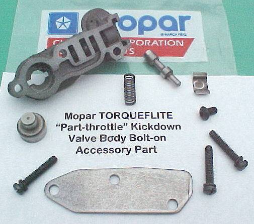

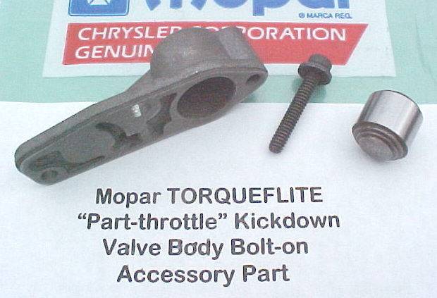

The following diagram illustrates the location, although prior to 1971 the flat steel plate isn't present on PTKD transmissions (it's simply a closed casting, not flat on the end). A&A used to sell a kit, as did DC/MP. Both dispensed with the flat steel cover plate. Yes, you have to drop the valve body but it's a very-easy mod. Once again, in case I wasn't clear, the PTKD can be installed on any '66-up 727/904. The necessary passages in the valve body are the same and the mounting provisions are there.
img_1067-jpg-jpg.1715612300
This is what the '66-'71 PTKD valve body looks like, with the A&A part being a similarly-shaped billet version:
simple-jpg.1715166065
'71 and later, it looks like this:
complex-jpg.1715166066
Either style does the same thing. I'm not sure why it got more complex during 1971. I'm also not sure if it's a model-year difference or calendar-year rolling change.
