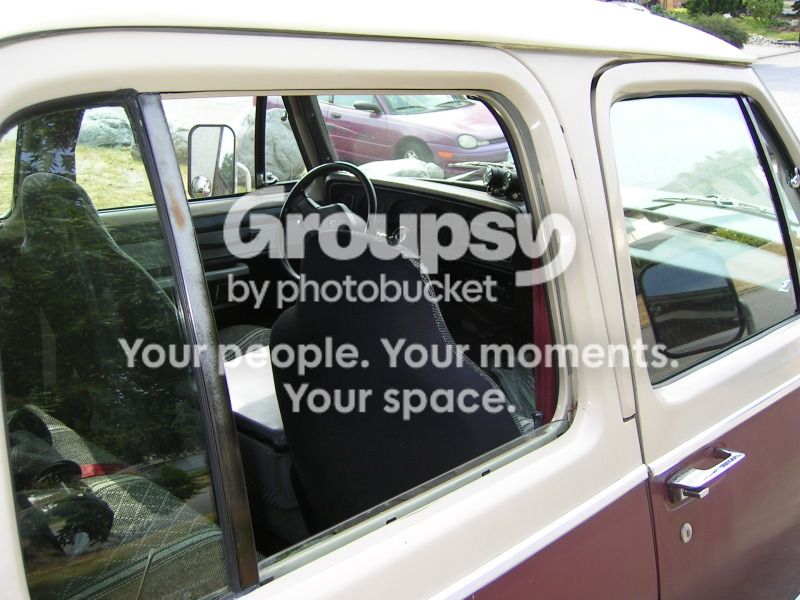

Well today I thought I'd tackle the window seals on the back doors...turned out to be a bit more of a job then I planned so only got the one door done today.
Here's how the fun went....The old seals were so cooked and dry that the windows would only roll down a little. It took a lot of chipping and breaking to get the old seals out.
Old seals in place...
My snap-on pick I use so often...little piece by little piece the seals came out...
After about an hour I finally got everything out of the way.
