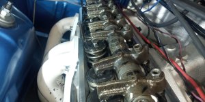

I've got the valve covers off, the rocker shafts are torqued, nothing is loose but that doesn't mean anything until I've looked at each one while the lifter's on the base circle. I thought it was kind of odd that in the photos it looks like only one side hasn't bled completely off, but again, that doesn't mean anything but a snapshot in time.
20240826_184145-resized.jpg20240826_184206-resized.jpg20240826_184312-resized.jpg20240826_184329-resized.jpg
I read of some Fram parts not having Anti Drain Back Valve (ADBV), which can lead to lifter bleed, but according to the Fram site, they all have an ADBV. If an ADBV is what I think it is, a rubber looking seal behind the end cap, it's definitely got one in it.
In a close up of the rocker adjusters you can see some are sunk, others are not. I didn't pay enough attention to that when first noticed because by then I was just sick of it and I had the pre-load that I needed. It was at the limits on some of them though to where I didn't think I was going to make it.
Maybe that loosened up just enough after starting the engine to where some of them are rattling. Or, maybe the cause of those sunk adjusters is wear (but where?) that in turn causes noise?
But I mos def had 3/4 turn after zero lash.

I see at least 3 in there that could use a longer pushrod.
I think the next step is to loosen all adjusters one turn, and check/set the pre-load again. I think I will have to use the TDC method to be sure I'm not missing lifter action all the way at the top. IOW I don't trust that one or more lifters isn't bled off to where the valve spring has closed.
Pushrods aren't really an exact science. I measured at several points in my engine, averaged 'em. My adjusters weren't consistently at the same depth, despite being solids. I didn't sweat it because the lash was good across all 16 lifters.
Yeah I dealt with measuring for the pushrods as an inexact science too, but it kind of has to be unless you've got a fully kitted out machine shop. I remember measuring and remeasuring over way too long a time period because I was never sure I got it right.

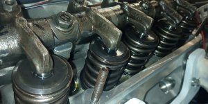

There you are dammit. I put the full size photos out so you can zoom in to see what I finally noticed...
It looks like some rocker arms are hitting the valve retainer. If that's what is making that perfectly straight line on the retainer, this would be called dodging a bullet.
Well I've never been so disappointed to have not found a problem.
Those lines are just grease or something on the retainer. It wiped right off. It's weird that the other side does not have them. So there is something different there.
