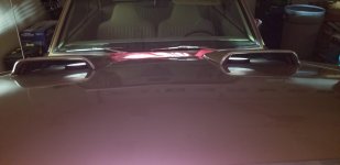

Installed a new old stock 2 barrel BBD carb, and Goldmember runs beautifully now. Had some time after work today, so finally cut holes in the hood for those twin scoops...
Pain in the butt, but used a bi-metal hole saw and went very slow, with bit of cutting oil.
de-burred and primed the bare metal
Installed rubber inserts
View from hood
Now I have to vacuum and toss out that pink sheet. I love pink.
Never use cutting oil on a hole saw. AVE said so as did a machinist friend of mine.
I'll remember that for next time. Any particular reason why?
I just tried to keep it cool so the hood wouldn't distort.
I guess they are designed for slow RPM, and no cutting oil. Other than that. I have no idea.
Oil will keep any filings in the path of the teeth, negating any cooling or lubricating benefits.
NEVER run a hole saw fast. Also, don't ever loan your hole saw kit to anyone! DAMHIK to not do this...
That explains why I had to keep wiping the cutting blades off with a rag. I went super slow
