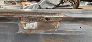

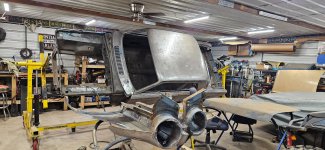

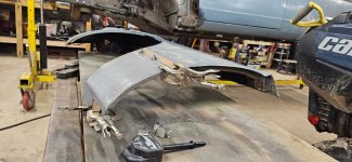

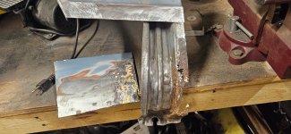

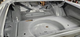

Today was rear panel day. I had to repair a small 1 inch section of the right side edge. I forgot to take pictures of that but I did get one of the completed repair. After that I had to add weld to close up a bad gap near the trunk lid where the rear pannel meets the quarter. The stamping was not straight and it didn't fit well before I cut the panel off of the car. Then I made a patch for the left side. That is a bigger rust hole. I'll fit and weld it in once I finish welding the panel to the car.
The 1st picture is the 1 inch patch on the right side. The 3rd picture is where I fixed the gap.
20240324_095304.jpg20240323_171429.jpg20240323_171422.jpg20240323_171417.jpg20240324_095310.jpg20240324_095204.jpg20240324_095215.jpg20240324_095208.jpg20240324_095232.jpg20240324_095530.jpg20240324_101308.jpg20240324_095630.jpg20240324_144415.jpg20240324_144423.jpg

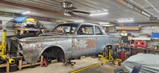

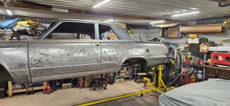

I finished the rear valance this past Sunday.

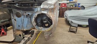

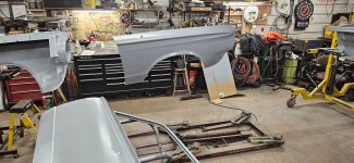

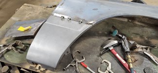

Next I plan to hang the doors and front fenders. I need to repair the lower "dog leg" area on both fenders. I want them on the car to make sure I don't introduce a twist and to make sure my lines stay correct.
A few pictures of Sundays repair work.

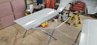

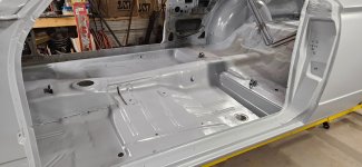

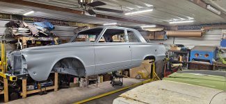

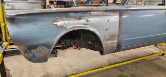

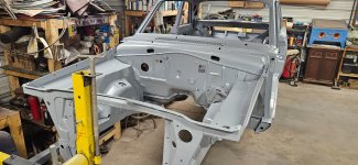

I have finished the metal work . That includded repairing the dog leg on each front fender. Now I'm on to paint removal and then the body work. 1000005025.jpg1000005025.jpg20240915_123523.jpg20240915_181040.jpg20240915_130714.jpg20240915_130727.jpg20240915_130736.jpg20240915_133908.jpg20241021_190029.jpg20241023_193227.jpg

Nice work, as usual.
Are you going to epoxy-prime before filler work, or go directly to filler over bare steel?
What do you recommend?
For anything left in bare steel for ay length of time, I like to get it into epoxy primer as soon as the bare steel is exposed, sandblasted, etc. You can apply filler directly over the epoxy after scuffing it with 220-ish or a good red scotchbrite.
Two full-wet coats. You can roller it on, spray it, brush it... a panel at a time, or a whole side if you prefer. Wash and wipe first with a quality wax and grease remover or final wipe solution. Hand prints, atmospheric moisture, fine mist from air lines... all killer to a paint job.
The epoxy can sit for years if not exposed to UV light or heavy weather. Bare steel... not so much.
