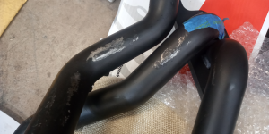

Passenger side needs a dent here for the TB to pass by
Driver's side PS box spots
DS TB spot

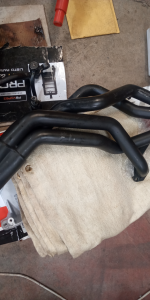

Now to figure out how to do it. I've got a mapp gas torch so it will get extra hot, several pieces of old pipe to try to give it some shape, and a BFH. What I don't know is how much support it will need and what works good for that. I suspect just banging on the pipes laying on the floor isn't the best idea but it's the only one I've got right now.
Because you'll only be heating one side of the pipe why not cushion it on a pile of wet rags?
The yellow blanket looking thing in the DS photos is a fiberglass welding blanket. I'm thinking of supporting each header on wood blocks covered by that. It won't get hot enough on the bottom side to cause combustion in a 2x4, especially with the blanket stuck in there for some padding.

Actually it turns out the way to bang on a header is to throw that welding blanket on on the floor, lay the header down on that, heat it up, hold it with your foot, and wail away.
I didn't find anything bigger than a 2x4 to use as a support, so that wasn't going to help but it wasn't necessary anyway.
I banged on both, retried the passenger side since it cooled off while I was banging on the driver's side, and it needed more banging so I did that and then quit because I didn't want to wait until it cooled off before I could touch it. The driver's side promises to be a real production going back in so I'm not even trying to fit that in until the other side is OK.

I think I'm finished with the banging, or at least nothing is touching on either side. I'm not going to even think about how much clearance there is but decided daylight is plenty. Now to paint them and get things put back together.
I'm here all worried about getting the headers clean and a good coat of paint on them, but then I recognized that break in is likely to burn off any paint that I put on them anyway. I won't be in any hurry to take things back apart to the point I can send them out for coating either. Maybe next winter, probably never.
FWIW I bought VHT white. IIRC the key is a thin coat because it eventually turns to powder anyway, or at least the late 70s mix did.
Headers are painted. 2 cans of primer, 2 cans of color. Don't look too close. There's a special process for the final coat involving getting it all sprayed within one hour (or waiting a week to put the next coat on), which I followed, and heat treating it in steps up to 600* F, which I laughed at. They're going to get plenty hot soon enough.
