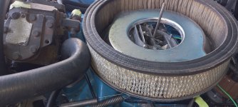

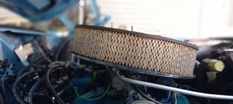

I don't recall, is it a stock cam or aftermarket? The erratic vacuum would tell me aftermarket. If stock, the vacuum could suggest slight compression leakage due to non-use for a period. This may self-cure after some road time. And for the "clunky noises", Do you know how many parts are moving around in there?
