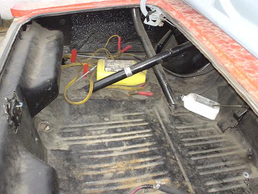

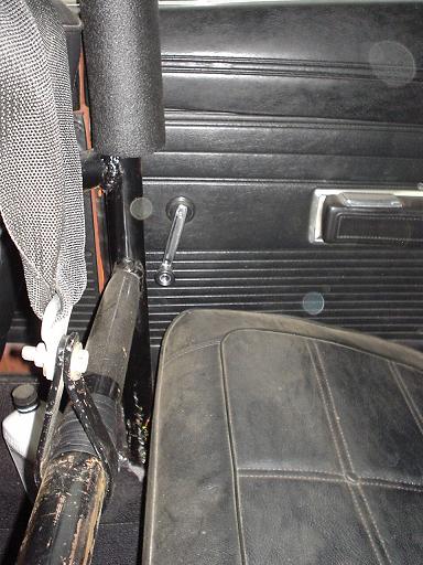

When I put mine in the 69 I used compation engineer and I didn’t have to change it much for everything to work out ok (fitting wise and using the window cranks) I just lowered the front bars to make getting in and out easy and extended the rear bars to the trunk. I did this just so the body would stop sagging, I had it jacked up in the middle before I welded the cage into place :D. I'm gonna give her monthly start up today so I'll try to take a picture of the trunk.

I'd be curious to see some pics of the comp engineering bar....is it an 8pt ? Mine is a S&W racing "prostreet" setup and the front bars had to be custom bent....other than those mods it went in pretty easy according to the chassis guy. If ya get a chance post some pics.....thanks,
Ron
It is a 8 pointer, but I left out the 2 that connected on the drive train hump. Didn’t need it, because the cage was just to keep the chassis from sagging and this girl never saw the track. Used the extra tubes to make the dukes of hazzard style push bar :D.

Put the front bar low to make getting in and out easy.
Its hard to tell from the picture, but there is enough room to operate the rear window crank.
Here the trunk
