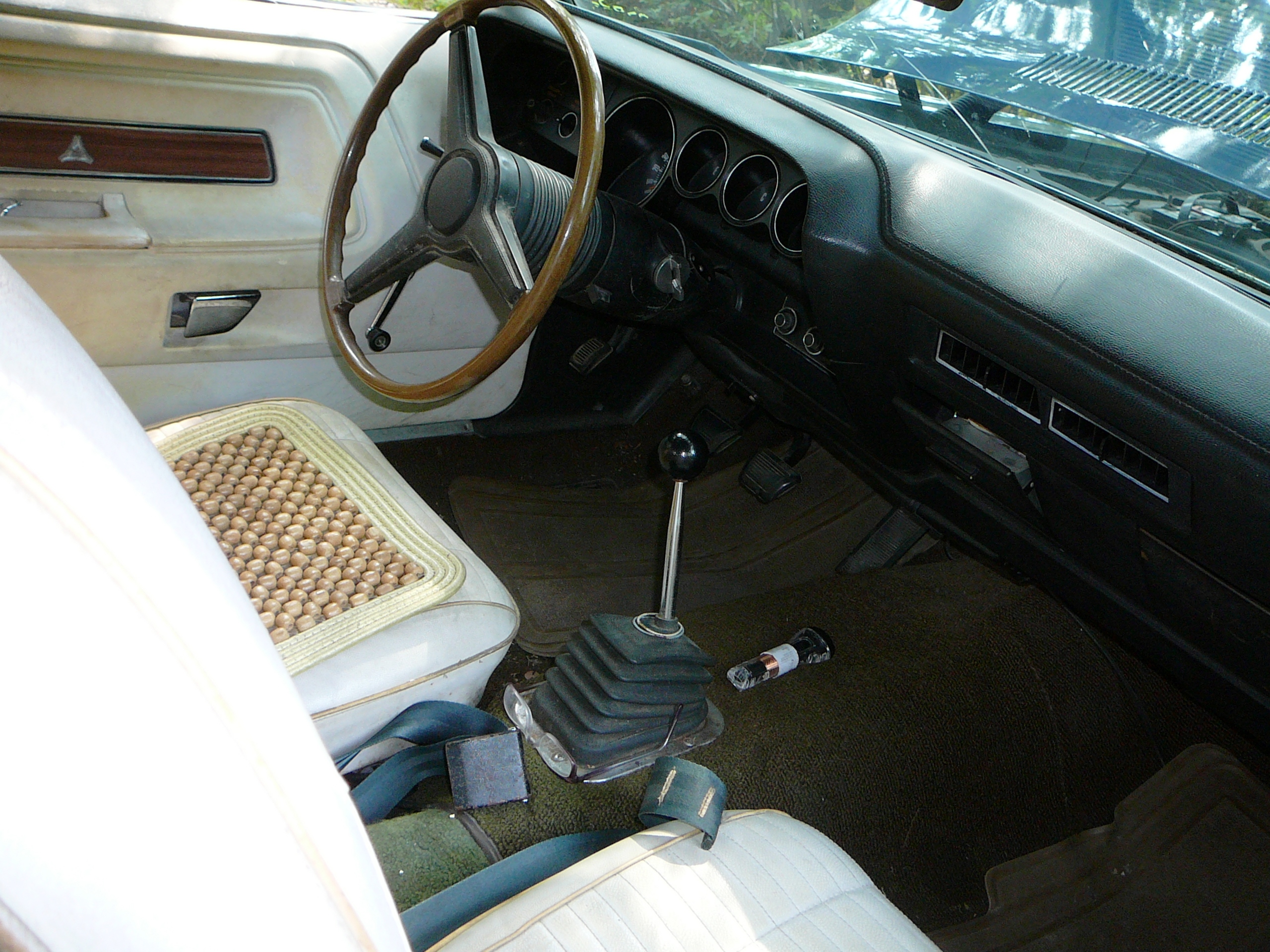

The shifter was a plow cable, routed through a hole in the floor. Its handle was a machine screw through the end fitting and wrapped with electrical tape. Park was all the way back, with 1st being all the way forward.
Apparently kickdown linkage is for pussies. Despite this, the transmission fluid was beautiful red. My guess? They tried changing the fluid and filter when the car stopped moving. "I don't need no kickdown! I can just push forward on the plow cable!"
