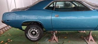

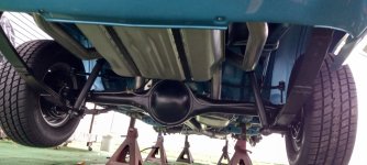

I LIKE rally wheels, wish they were 15" but I will settle for the scaled down look!

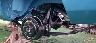

most of the pit marks will be covered by the nice shinny new rings! 20231205_134255.jpgSo I finished off the rear brake lines & put the e-brake cables back together, tightened them up till I couldn't turn the wheels by hand, may need a bit more but I think I have to adjust the brakes first, I'm at a slight drag turning by hand.

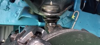

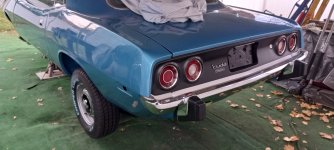

rear ready to hit the ground. 20231205_153705.jpgStarting to look like a car back there. 20231205_153735.jpg20231205_153818.jpgHad enough time to start on the front ball joint boots, so far the lowers & all the
small ones look good?

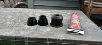

but I may have put the wrong one on, I was thinking the short fat one went on the uppers. 20231205_154244.jpg
Quite a difference in size compared to what came with the kit!
I had them laying on the ground & grabbed the wrong one when I was applying the grease & didn't notice till I was cleaning up.
Does it matter?
Should I change it it's just snugged down at this point? 20231205_154506.jpg20231205_155142.jpg

So your photo shows L-R: the boot that you thought should go on, the one that you put on, and the original one?
It looks to me that the main difference between the two new ones is the hole for the stud to pass through. That should tell you which one is right for your car.

Got the boots & the grease at summit.
Don't know where they are but stuff comes quick & usually with free shipping.

Yes that's the line up.
it seemed to go on the shaft well & snug fit at the top.
Lowers are not coming apart, well at least not now. I guess I'll test fit the shorter one on the other side when I do that side & see what it looks like.
Pretty sure the order was for 2 uppers & 2 lowers?

I just checked one of the sets of ball joints I have for my Challengers. The lower has a slightly-larger diameter at the base of the stud than the upper, so if I had to guess I'd say you inadvertently got it right. 😄
sometimes you get lucky!
