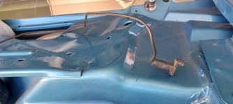

So today was laying out the wiring up front, while I was out there I started up the heater in the garage so I could paint the drums.
light harness looks good, just one wire I have to look up red wire (extended in black) off the light harness20231120_132633.jpg

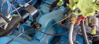

On the neutral safety, 2 questions, should I at least tape or sleeve those bare wires all the way down to the tranny? & on my main plug there's an extra wire (brown w/yellow tracer) quite long not sure where that goes or if I need it, I think I have another plug without that? 20231120_135420.jpgI need a coil, should I just order a stock one, everything else is now stock.

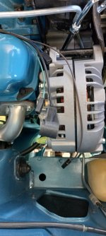

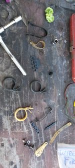

Not sure I can use the one that came with that old distributor? 20231120_132435.jpgchoke, alt & washer pump wires are in the right places. 20231120_132736.jpgthink I have to otder the wire holders, most of the old are broken. 20231120_133056.jpg

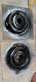

Then it was inside to warm up & work on the drums, somehow I can't stop myself, ended up almost at bare metal. 20231120_154619.jpgthe clear is still wet, but I had a lot of matt clear that I don't think I need any more so I used that since they won't show & saved the satin for up top. 20231120_161538.jpg
The brown wire with the yellow tracer is your neutral-safety switch connection to the starter relay. Unless there was a plug exactly like that one on a different harness (like the one I sent you) it's literally the ground wire for the relay to operate, so yes--you'd need it. I think the harness I sent you terminated in a plug for the switch on one end and a three-way connector on the other.
Not sure on the large red wire with the black extension on it. On the factory wiring diagram, the only large red wire I can find in that area should be connected to a 16ga fusible link, then to the starter relay... but it looks like you've already got a large red wire at the starter relay. Post a picture of the starter relay showing the connections on it so I can see what you've got going on there.

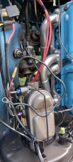

OK, on the new pos. battery harness, the smaller red one heads down towards the starter & back up again, not sure if it's split out of the harness parts way down or if it goes all the way & back up, pretty sure it's the right wire for the relay post & nut.

Red to black is on there, I think the gray went right to the battery, a lot was changed on this car, but it did run like this? DSC07222.JPG
K here's a clearer one & another pic showed the gray direct to the battery terminal.
the black was the fusible link line.
The small red wire on the positive battery post goes to the B terminal on the starter relay. There should be a separate small wire (OE was brown) coming off the starter connector itself that goes to the S terminal on the relay.
On the factory wiring diagram, the fusible link is shown on the red wire which, on your car, has the black wire spliced to it. On your old setup, it looks like the link was on the small wire from the battery. It's entirely possible there was a production change, since there are at least two different 1974 E-body engine harnesses. Either way is fine, as long as you make sure there's a fusible link in there somewhere. You could even splice the old one in where that black chunk of wire is now.
There was another one on the main post, yellow, I suspect that was part of their bypass the relay setup, heaven knows what the 3 cut wires were for???
I'll get a pick of my new positive cable the one for S comes up from the starter as does the red for B, that comes out of the harness about half way down.
Pretty sure the gray they used was direct from the battery with no fusible link at all. Going out to freeze in a while I'll at least get this part looked into! DSC07252.JPG
