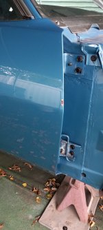

Well after about 3 hours of tweaking this & pulling on that we managed to get the drivers side as close as it's ever gonna be & ran outta daylight! 20231109_163651.jpg20231109_163712.jpgdoor gaps a tad wider at the top, but that may be my quarter skin install, now I can start on the fender, once we do the other side & I get that fender set in the back I can start putting the front end together & the hood!
Oh we had fun, every adjustment we made changed 3 others, I think we got lucky towards the end, we somehow hit a spot on the quarter glass where it lined up with the door glass & just tightened it all up & it stayed there.
All the other times as soon as we rolled the window up & down it friggen moved!
I have the same mess to deal with on the other side!

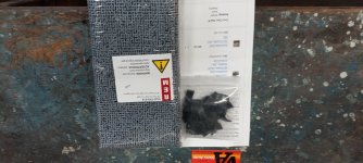

Well now it goes to trash in about 30 seconds, the callouts were very tight going in, not even all the way down yet I tried to get it out to file the holes & SNAP, the first one broke!!!!!!!!
so I file the holes, get the second one in & go to tighten the one speed nut you can even get to & SNAP the second one breaks!!!!!!!!!!!!!!!!
So I pull out an old 340 callout I had & it slips right in the holes with no tension whatsoever!
Will be calling year one tomorrow to see if they will do anything, I waited like 6 months for these!20231111_160744.jpg

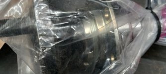

Now I'm thinking I need something to work on that I won't damage, since I have the rear flipped over I can put that together, the one with the adjusting ring goes on the passenger side right? 20231111_152822.jpg
,,,,,,, since I have the rear flipped over I can put that together, the one with the adjusting ring goes on the passenger side right?
Make sure that you have everything oriented in your brain which is right, left, front & rear because it IS upside down.
We flipped it, I knew I couldn't move it much after all that weight was on, now if I can't get it off my little stand it's sledge-o-matic time & let it bounce on the nice new tires! (the tires will only be a few inches off the ground)

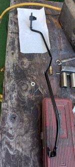

Started with the throttle cable, wasn't easy getting those retainer strips on the plug, but I managed.20231112_131642.jpg

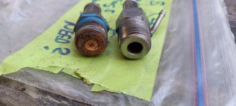

then I decided to put the fitting off the old manifold, it had an extra off shoot that I'm not even sure I need, but ends up glad I did the old one was plugged solid. 20231112_133713.jpg

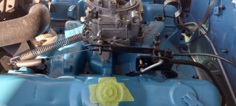

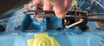

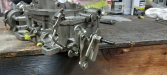

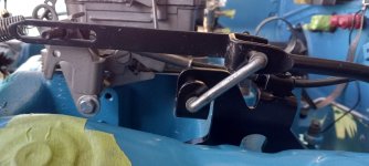

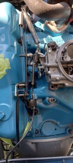

Now it starts to go bad, put on the carb, connected the throttle cable & put in the springs, had to move the big spring to the far little hole, had no tension at all, the smaller one still has no tension! 20231112_144110.jpg
somethings seriously wrong with the kick down setup.
First does that spring go there, only place that looked like a home for it?
After installing it was quite short, went back under & maxed out the adjuster, still way off...........20231112_144021.jpgIf I remember correctly that swivel should be straight up, in this position full throttle (oh yea I did recheck that after I bolted the carb down, seems good to go) does not even touch it. 20231112_144221.jpg
there's one more spring I think goes on the kick down side, but It would be way stretched out if I hook it up now, so I stuck it back in the bag. 20231112_150857.jpgWasting time I stuck some goop on the emblems, doubt it will hold but they look better for a little while!20231112_145345.jpg
