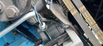

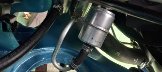

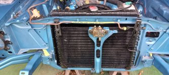

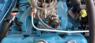

Started with the A/C condenser, I hope that line to the receiver comes with the kit, will be no fun to clean up! 20231107_130950.jpgThen I started on the lower section of the fuel line, I had to strap it to the alternator bracket to keep it off the alternator.20231107_130805.jpgThat put a little tension on the hoses.20231107_130825.jpgIt;s still rubbing the compressor & water pump but I will wait till I get it hooked up at the carb before I make the final bends20231107_130915.jpgIt's in the general vicinity of where it needs to be! 20231107_134010.jpg
Re-checked the full throttle on the carb, I put the open square hole plate closest to the carb & it looks good, I will re-check when I bolt it down.

The carb's going to clear that plate without issue. It's the manifold itself that's going to create a clearance issue if there is one.

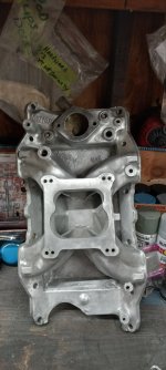

Now I'm out there trying to find something to work on but I'm so pissed at this car now I didn't even want to think about it, so I took the intake I washed off & started cleaning that more!
Mindless rubbing & drilling the wire wheels! 20231108_152132.jpg20231108_152151.jpg
Now I didn't want to spoil all your fun so there are many nooks & crannies I didn't get!
Now if I've destroyed this on you in any way, just let me know & I'll toss it back in the junk pile!
