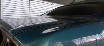

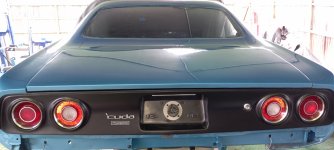

Working on the 5' rule she looks good, I put a coat of wax on that top rear section, boy do I have some more buffing to do! 20230505_155035.jpg

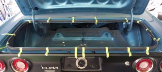

Got the trunk seal on, didn't make to much of a mess with the nasty silicone. That's why she's popped up in the back.20230505_152623.jpg
I couldn't even close the trunk, I raised it all the way up & way high. 20230505_153623.jpg
Put it down a little somewhat better, now I'll give it some time to squash down a bit ( I hope).20230505_153743.jpg
On the other car it only popped up in the pass front, never did get it all the way down?

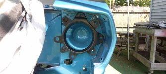

I even tried to prep for this while I was at the paint shop, I thought I bought almost exact replacement screws, turns out the darn things are metric!!!!!!
First I was going to mount the headlight brackets, turns out I never cleaned up the hardware, so that's in the tumbler, found 2 extra bolts so I stuck those at least in place.

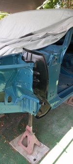

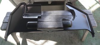

The frond headlight splash shield went on fine with 4 original screws YEA! 20230509_155102.jpg
So I stick on the upper fender bracket & then turn to the rear shield, fought with this for the rest of the day, after fiddling for quite a while with the holes they used It just didn't look right, no matter how I adjusted just off. Finally realized the the last dingbat to put it on made his own holes, lined it up with what looked like the right holes, but one is missing?
So I use al the ones that lined up & wa la, it looks right now, so I drilled a new hole where it was missing, had to use 2 of those metric screws but it's finally on & correct!
I must have made 30 trips in & out of the garage, I hope this will set me up for a smooth quick operation on the other side. 20230509_155041.jpg
Are you sue you're going to be able to get the fender on with that bolted to the body? I remember something like that from the Duster but don't remember if it had to be bolted to the fender or the body first, or if it had to be installed after the fender is in place, but it was something.
All good, these don't bolt to the fenders, I've had em on & off a couple of times already.

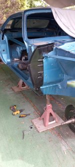

Today went a tad better, shields went on without a hitch, which should have been the case on the other side too, I used the metrics on the big shield & the little one, then I noticed I only needed 3 on the big one & had three merican ones left, so I switched them out, so drivers side is correct in the back & pass side is correct in the front, wonder how many years it will be before my fo par gets noticed!
All merican! 20230510_151858.jpgSo I got all the hard ware clean & painted the bolts for the bracket I can finish that up tomorrow, the bolt holes on the new fender don't line up as good as the old (orig) one, hope there's enough adjustment left? 20230510_152159.jpg

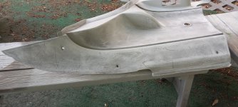

A million little nubs all over the place, this was the worst area, thought THE END!
sprayed the bad top area with guide coat I have 4 coats on this area, see how many of the big gouges I can get out?20230511_142240.jpg
A pleasant surprise, the nubs sanded off & there seemed to be primer underneath.20230512_151228.jpg
Did hit some black but most of the deep ones ate filled, hoping 2 more coats of primer & I can shoot paint again.
So far its all sticking good, no cracks & I've been flexing the little ones a lot during sanding, I'm hoping they won't peel again? 20230512_151239.jpg

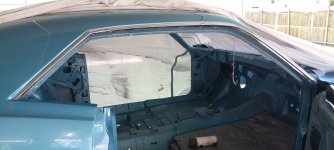

Finally nailed my son down & we got the passenger door on & aligned pretty close. 20230512_135542.jpg20230512_135557.jpg
Been a LONG time coming, but at least one side is getting close to done. Now I know I'll put off that door glass as long as possible it will be a battle!
Picking up my friend's buffer so I can get some trim ready & then install the upper seals.
So far the door opens & closes nicely. 20230512_143550.jpg20230512_143621.jpg

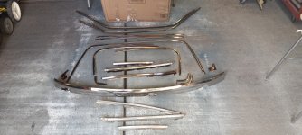

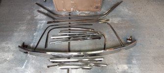

Then I set up the buffer, started on one of the upper window trim which again took me about a half hour to find, I thought I was organized guess not as good as I thought.

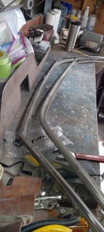

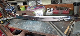

Then I pulled out the bottom windshield trim, wanted to see if some of the deep scratches would come out, no luck there but when done at least it will shine! Almost there! 20230513_151715.jpg

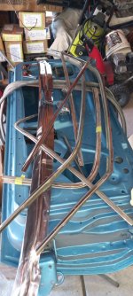

Can't seem to get a direction, I'm jumping all over the place, the trim started so I could do the upper glass trim & seal.

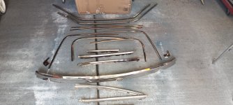

Turns out the three pieces I didn't do yet are needed for that side. All in all they are looking pretty good couple of minor scratches & dents here & there.
So as I'm laying them out I notice my little corner pieces are noy there??20230515_155311.jpg
Oh great another 3 hour hunt, so I read my labels on a few boxes, no luck there the I looked at the big box way up in the corner, where some of the trim came from, well miracles do happen, pulled that box first & they were in there!
When the sun hit my layout it showed a few pieces need a little more work, should finish the last 3 & some of that tomorrow, then back to sanding the interior panels & checking to see if I have enough gasket material for the upper trim to go on? 20230515_162908.jpg
Been there done that, even with all my labels & pics of the tear down I have to go on line to find how a few of the things go.
Don't remember having these problems with the other car, But then again it wasn't 14 years since I took it apart!

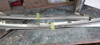

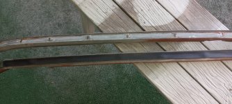

Trim is about done still seeing a few hazy spots on the big one, but going from top to bottom on them was worth the effort! 20230516_142243.jpg

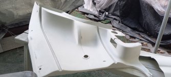

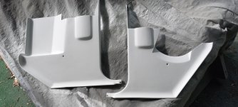

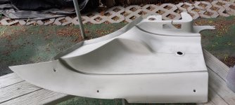

So I went back to those last 3 panels, kept telling myself on the little ones where they will be their good enough, then picking up the sanding block & doing more, till I finally kicked myself & moved on the one that will be seen. 20230516_164339.jpg
Got a good start on the sanding here, I think it will be ok, I've been flexing the heck out of the areas that peeled last time, so far no cracking or peeling! 20230516_164321.jpg

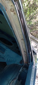

Finished off the sanding but way too windy to try & paint, so I went back to the roof rail, got the first layer on, then went looking for the seals.20230517_142454.jpg

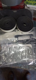

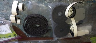

found the leftovers from the other car, but not enough. 20230517_142808.jpgWas just about to go in & order a set, then my head actually worked for once, in one of my orders I bought a bunch of seals, sure enough they were there.20230517_143941.jpgSo i stripped off the old ones on the outer trim & installed the new20230517_151757.jpgNow I stop, where the heck does the foam one go?
On this set all I got was a thin stick on & rolls of the foam, on the set for the other car there were 2 rolls of stick on, one a little wider than the other & the foam which I still have.
Before I screw up, where does the foam go?
left old set, right new set?????????
Started going thru that, takes a while, no luck yet, but now I may just pull out my book & see if I get lucky?
Still scratching my head I used the 2 stick on ones on the other car but for the life of me can't remember where the wider one went?
Some of the books on mymopar are searchable, others are just scanned images in pdf format. The body manual seems to be the latter.
Went to the body manuel & found about 100 places on those to put "ball" sealer, which I ignored, the main long one seemed to be where I have it, so I went ahead & installed them.

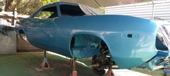

Wind was calm today so I got the last of the panels painted, far from perfect but passible. 20230518_162536.jpg20230518_162553.jpg
