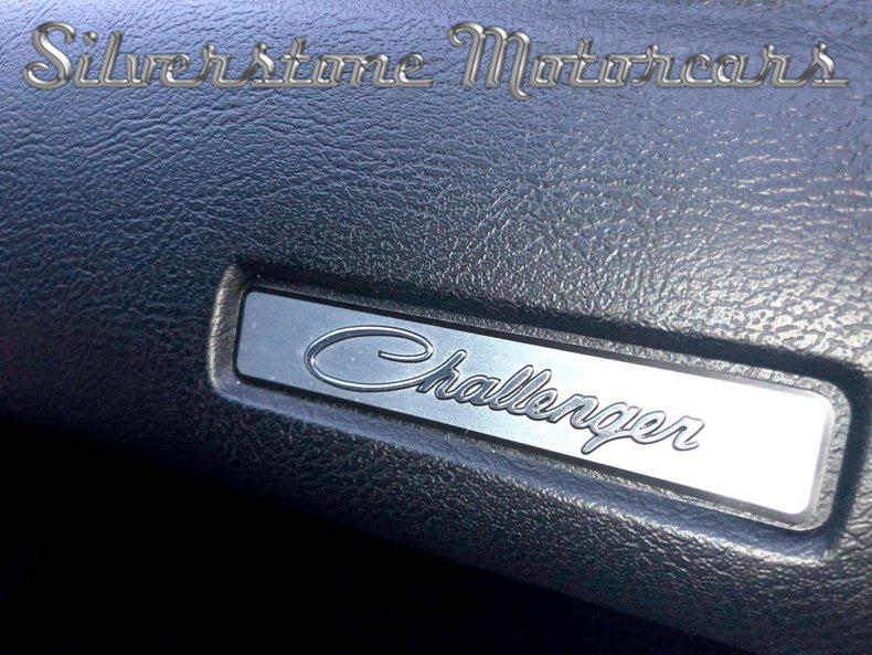

You can save a whopping $15 on your E-body, er, restoration by completely ignoring the frame and putting the decal right on the dash pad:
